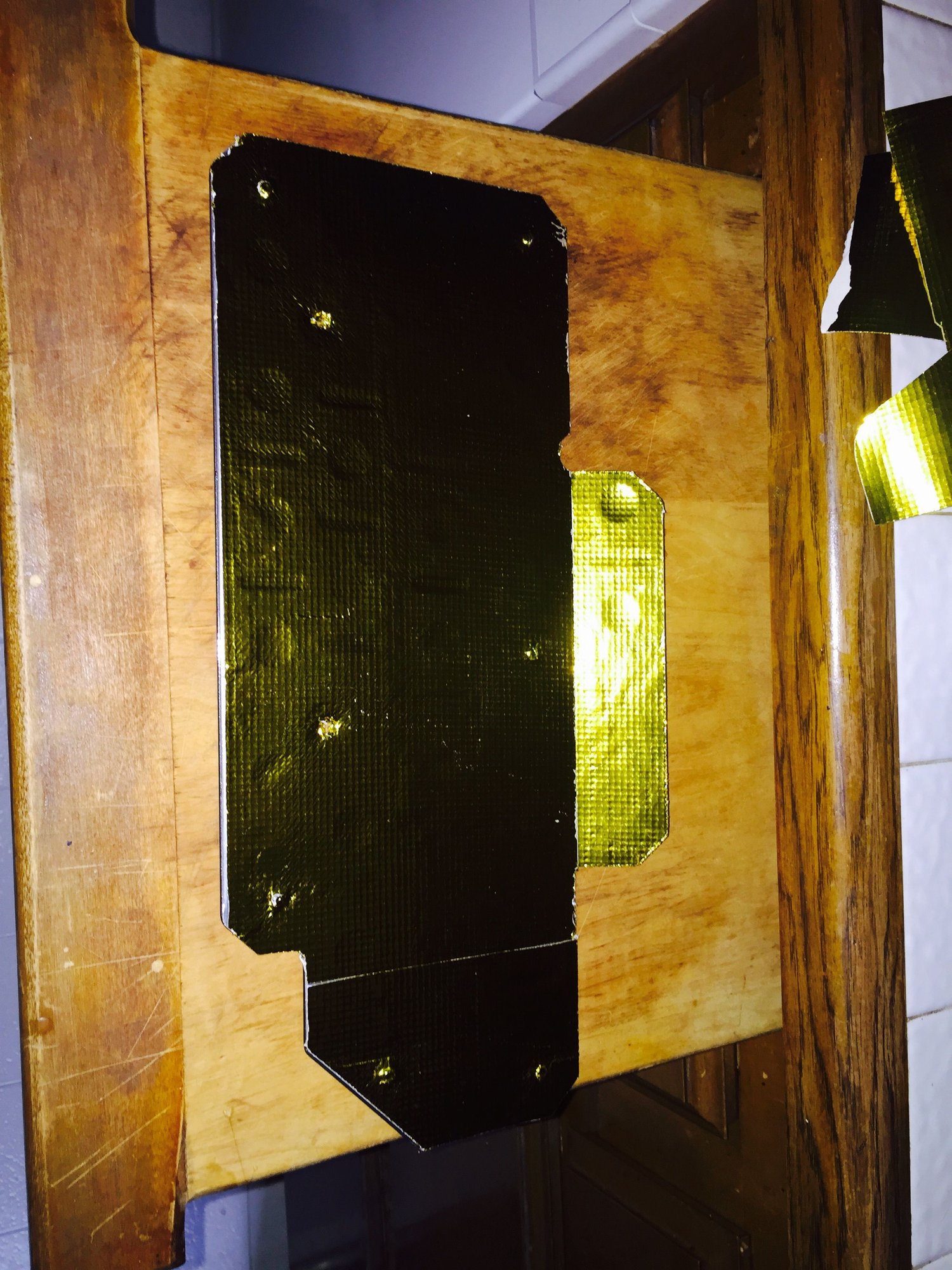

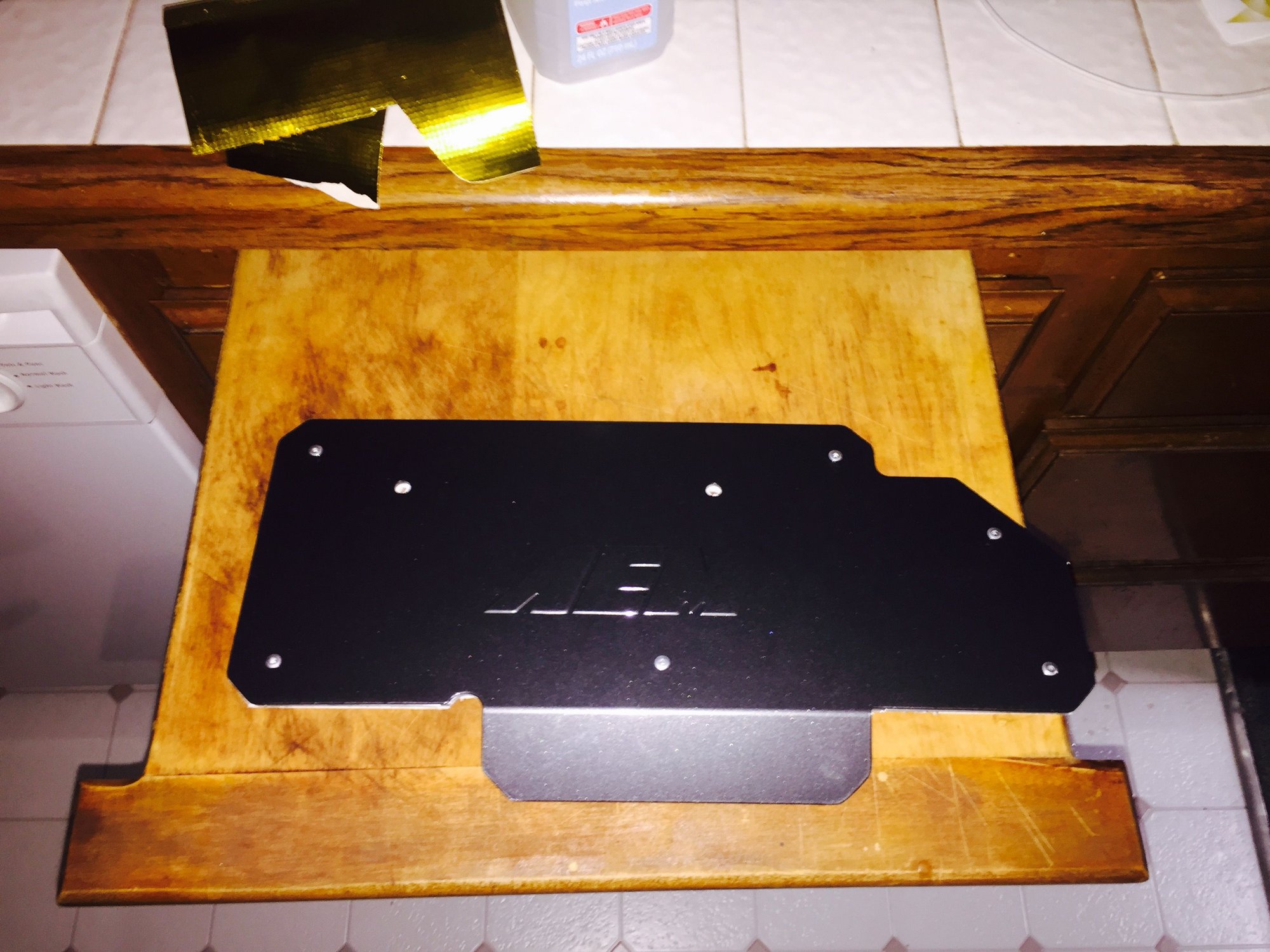

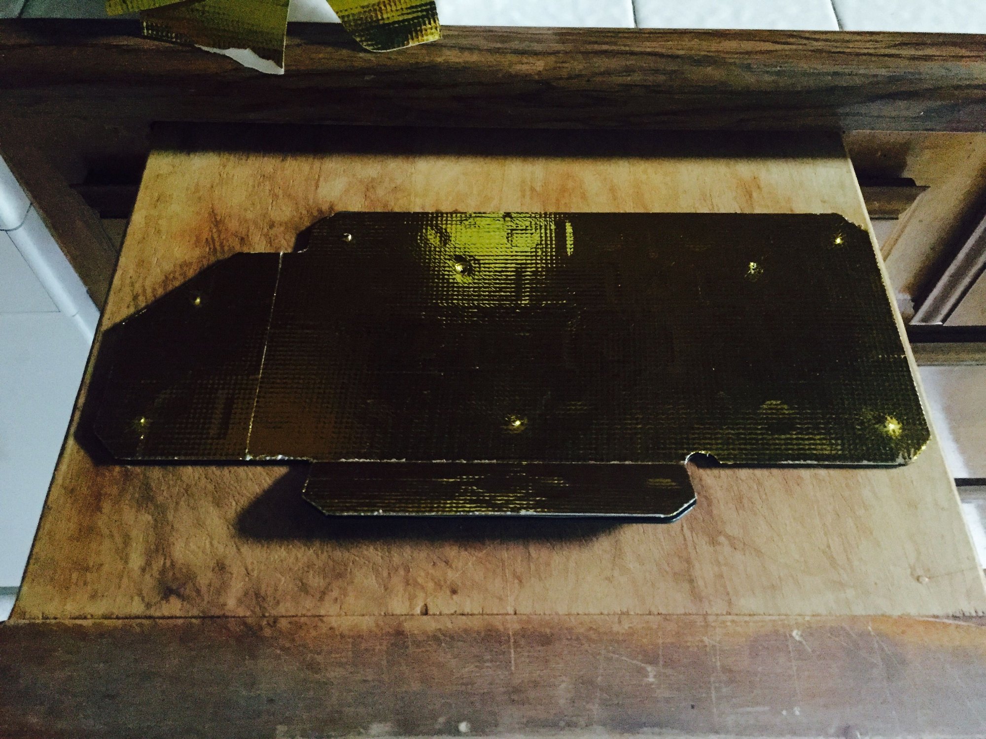

I use this tape that I use on my race bikes. This tape has a deflective rating of over 400 degrees; Mishimoto sells a similar tape. IMO best thing for the turbo is the bag shields and a ceramic down tube. That'll lower temps. I've had no issue with mine. I wish the plugs that hold the hood plenum in place were more robust, secure. Has anyone used anything else?
