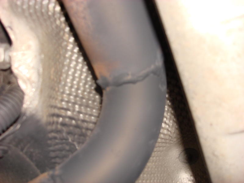

ONE BALL MOD
So this is what we did
One Ball mod
Removed the rear muffler the one that the 2 x exhaust pipes run into the pipe from the front of the engine and crosses over to the outlet muffler
Cut and fit 90 degree pip to suit then weld ..your one ball mod is done

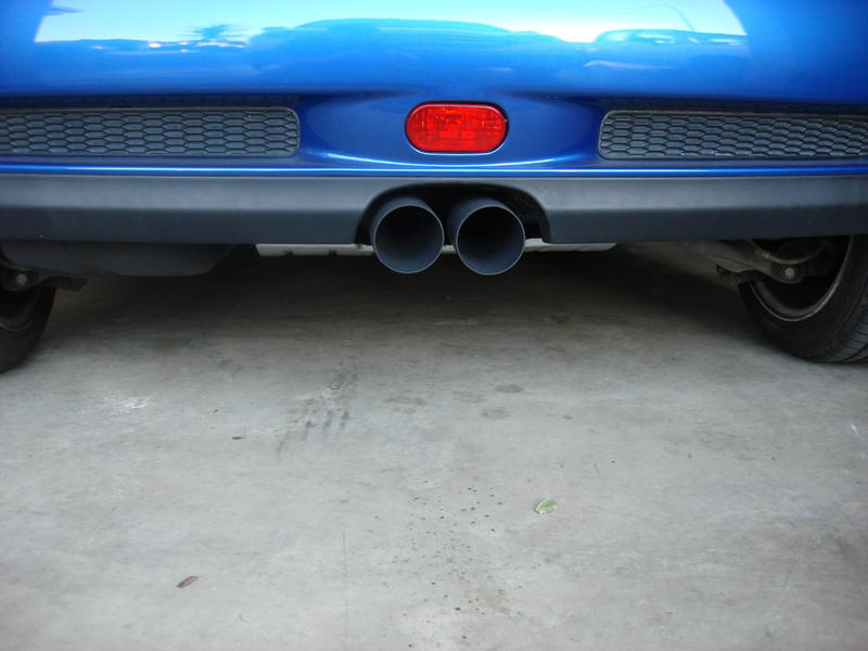

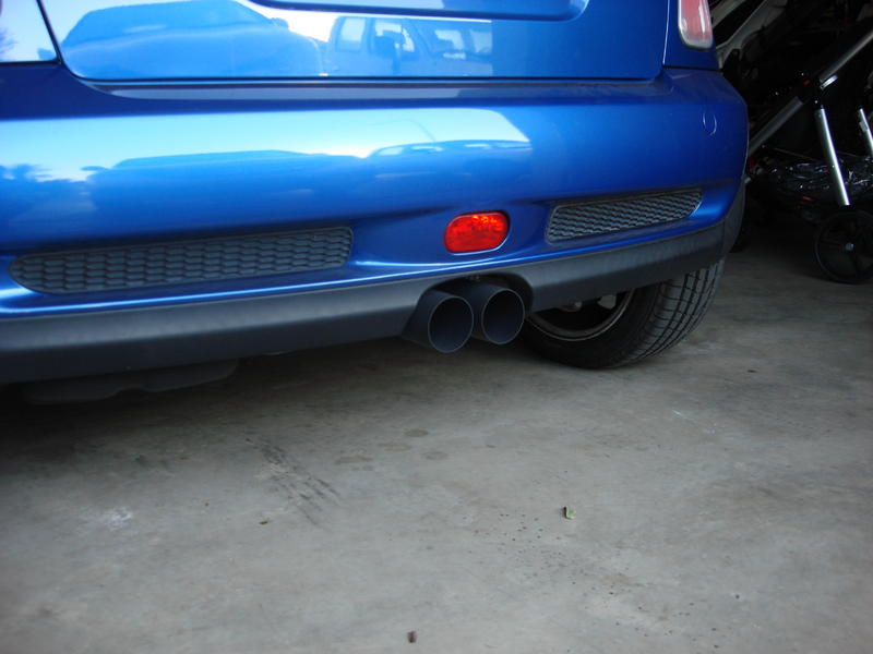

EXHAUST TIPS
Big Stealth exhaust tips
Remove chrome std exhaust tips by taking the little allen key screw out that locks it to exhaust pipe
Cut exhaust tips of just pass the flat steel pipe support
align 3inch tailpipes/tips then tack weld into the right spot then weld the inside of the tips so you cant see through ..your stealth tips are done
This DIY mod cost us $55.00
Good luck and hope this helps

Few more pics
Note... we still have to adjust the exhaust to the right a little in these pictures (easy job )
