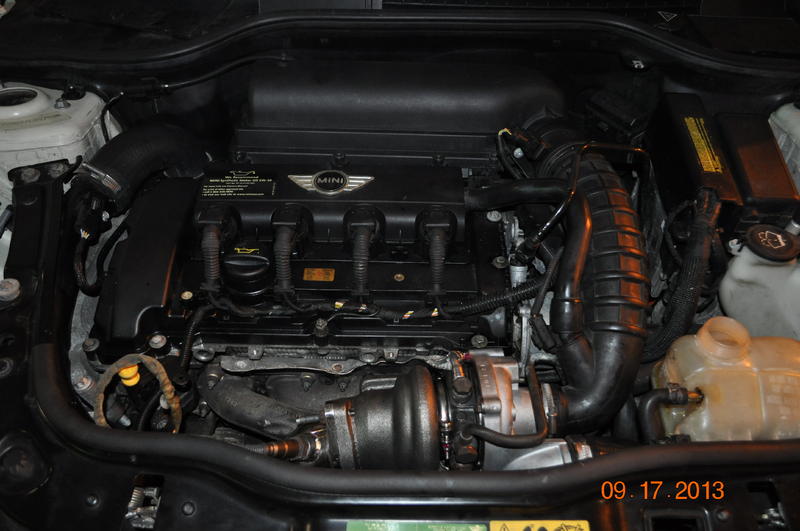

Hey guys, finished the turbo install - along with the turboback CNT system, nm torque arm mount, intercooler muffler delete, shielded turbo oil supply line and helix short throw adapter last night. all in all it took my buddy and I about 4.5 hours (including cooling car down, draining/refilling/burping coolant) with the heat shields being the majority of the labor. Those things are really REALLY secure. I have a few pictures so I will be posting them later today, when i download them from my camera. It looks great and so far it RUNS. There is a CEL from the DP, which was pretty much expected, and on the first test drive i blew off the lower intercooler to muffler delete boot since i forgot to tighten the clamp (vvvvrroooom PFFFFFFFF!) but got everything secure now and just keeping an eye on oil and coolant levels to see how much more coolant and oil this car burps through the cracked systems, especially with the new turbo plumbing. CNT catless exhaust = deep but very loud... will be adding a resonator in the middle shortly
It seems like it takes forever to cool the car down. I had to wait about 1hr 45mins to cool the car down to the point where I could finally install my diverter valve (maybe a 20min process) haha.
One of my lessons learned is to leave the car for a day if I have to install anything on or around the motor. Are you going to use the BMS can tool to clear your CEL or did you find a tuner that can take care of that for you? Those CELs can get annoying really quick! haha

hahah, we put the car on the lift, looked over the engine compartment and said "lets do the exhaust, shifter and mount while this cools down".... finished all that in like 45 minutes and it was still hot to touch we had no idea what to do next just pulled the intake tubing and stuck a fan on the engine bay for giggles. it depends, the guys at NM said they can custom tune for the turbo, but it wont delete my O2 code, so then id need a BMS for that. thats my backup option otherwise i plan on having RMW tune during a Helix dyno day, thats my first choice.
Mario Kart, thanks a bunch man, seems the car is using a little extra fuel keeping things rich to compensate right now (evident from the little puffs of fuel out the exhaust after idling at stop signs). that is sort of speeding up this tune process : / but as soon as they have another event at Helix im going to be there
