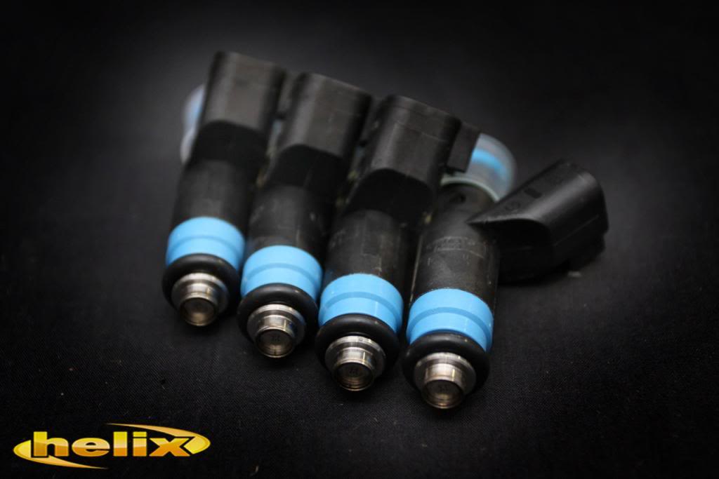

These dont look the same to me but i could be wrong.... EDIT: im assumeing the extended silver part of the inj. extends into the port?and the o-ring area seals in the inj port?
Genisis Picture from 034motoring
Helix 380/450???

Do you want to see pics of my 380cc to throw you off even more?
Genesis have different variations of the 380cc .... They all fit...
Helix 380/450???
The top picture is the most common iteration of Genesis 380cc. If you go to different vendors, most picture those. Yes, the silver nozzle extend into the port, and O-rings seat on the fuel rail and manifold.
The two photos from Helix are a bit dated. The black & blue ones are Siemens 450's. The off-white ones are Genesis 380's. At one point, the Genesis 380's were that off-white color, not for long though. Do a good images search. Also, you can always call Scott at USRT. He's always willing to chat about this stuff.
