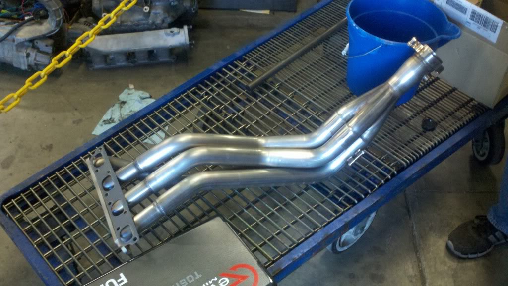

You also need the header, thats imperitive to get the exhaust out of the car not just though the head.
If you have a healthy bottom end you should do well.
since that dyno i have added a 17% pulley a meth kit
and a stand alone ECU oh and a Stepped race header.
