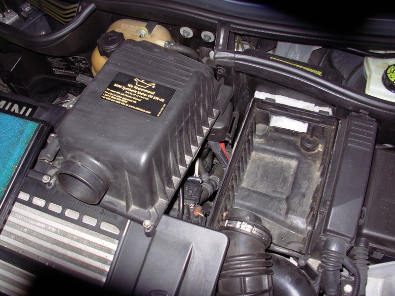

Okay so I just did the six 2-inch hole cut outs in the partition behind the air intake box. I wish I would have tried it without removing a load of stuff and just tried the cut outs with everything in place, but as has been said it's fun removing everything anyway. Now here's the thing, I could not manage to get the rubber grommet (?) in the lower (original) hole back into place and so I just left it out. Anybody see a problem with that? I mean I've now got 6 bigger holes all with no grommets so the little one shouldn't matter should it?
The only other problem I've had is that I destroyed one of the original clamps (are they re-useable anyway?) and could not find anything with that 5/16" band width at either Pep Boys or Auto Zone. They are all 1/2" and don't fit into the clamp groove molded into the ends of the hoses. I got an original one free from the parts guy at Mini but I'm sure a special tool must be need as I cannot get it to go on.
Any ideas on any or all of the above.
Thanks,
Ken
ps Drove the car without the clamp secured properly and I'm getting severe whooshing noises so I can't give a good assessment of the mod yet. I hope that goes away when the clamp is secure.
the wooshing noises are the noise from the intake, now that it has one less degree of seperation from the driver's compartment - enjoy!
Ah ha! Well...erm..no problem then if that's what it is supposed to sound like. Anyway I forgot to add one more thing I did which may sound a bit stupid to some of you...before I even started the job I special ordered a new partition just in case I didn't like the results. The whooshing can grow on me so I'm not going to swap back immediately.

Originally Posted by efcmini
Okay so I just did the six 2-inch hole cut outs in the partition behind the air intake box. ... I could not manage to get the rubber grommet (?) in the lower (original) hole back into place and so I just left it out. Anybody see a problem with that? I mean I've now got 6 bigger holes all with no grommets so the little one shouldn't matter should it?
I'm uncertain what you did...you put 6-2 inch holes in back of the separation partition, but what did you do to the intake into the airbox? I'm assuming you still have the stock airbox, correct?
BTW, the clamps are reusable. You need a set of channel locks or similar to get them to reconnect...

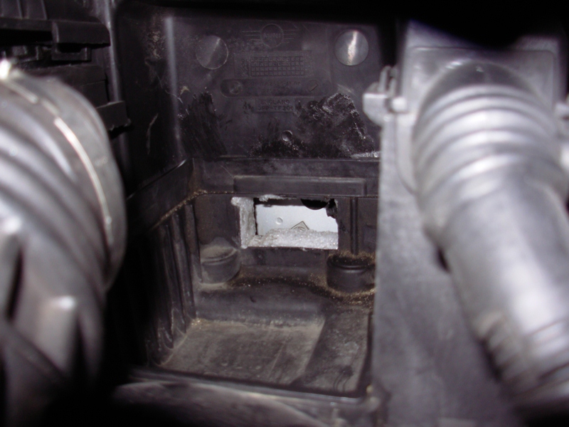

Here's some pics of my DIY airbox improvements....I currently run an ALTA foam filter. My next step is to add a flange inside the lid (opposite the S/C feed) and fit a unifilter...will probably also add another cold air feed from the cowl into the top half of the airbox at that time...
Attached Thumbnails Air Intake Box Mod question(s)-057.jpg   Air Intake Box Mod question(s)-058.jpg
