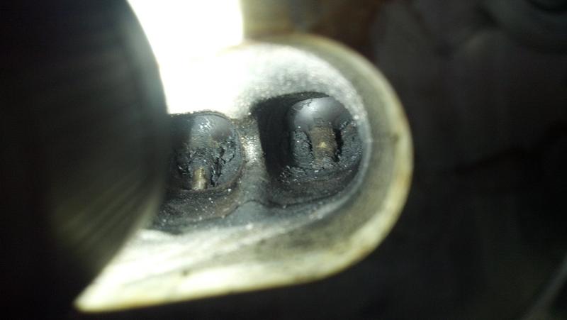

Cylinder Port
Contaminated cylinder heads when pistons broke
Attached Thumbnails Motor Disassembly-cylinderport.jpg   Motor Disassembly-cylinderport2.jpg   Motor Disassembly-cylinderport3.jpg

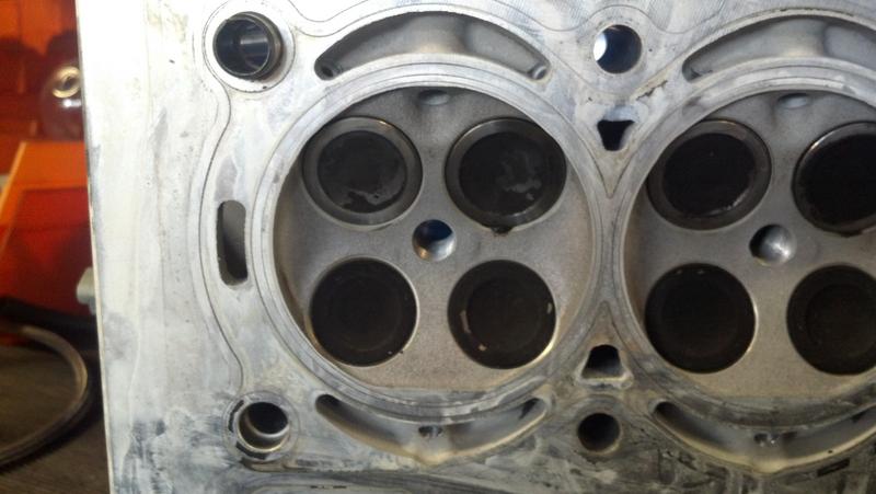

Pics of combustion chamber and intake port
Attached Thumbnails Motor Disassembly-combustionchamber.jpg   Motor Disassembly-intakeports.jpg
