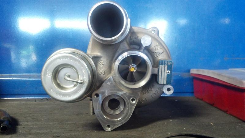

I finally got my hybrid turbo from GPOP. Had internal components swapped to a K04. I am still waiting for the pistons from Carillo.
Refresh my memory. Does a "K04" change mean a different turbine and compressor wheel with the associated housings? If not, could you detail what exactly changes on the turbine and compressor side? I remember people trying K04/K03 hybrid turbos a while back but then they ran off because of tuning issues. Good thing it's 2012 now and tuning is much easier.

K04 hybrid means stock turbine wheel (which is fine and plentiful), but larger compressor wheel.
So, same exhaust housing/turbine wheel, but machined compressor housing and larger wheel..
Allows for more airflow, aka more powah

Thanks for the clarification.
I thought about dodging the big power upgrades for my R56 until my wife told me she loves the MINI so much I'm not allowed to sell it for something else. So i'll be watching this discussion and Evolve Automotive's hybrid turbo project very closely

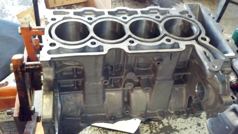

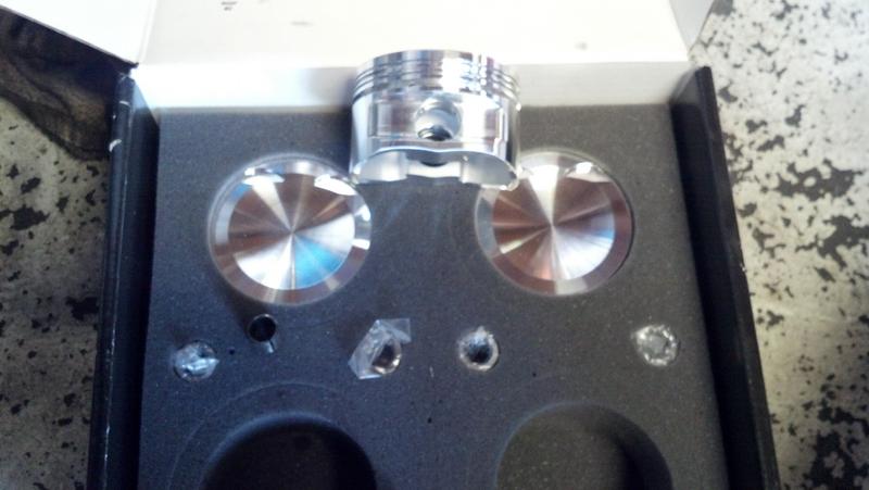

here is the pic of my engine bored and honed along with a shot of carillo pistons. its getting closer. i am hoping to get the car back in september
here is the pic of my carillo pistons. its getting closer. i am hoping to get the car back in september
I am hoping it's just a bad reflection in the image: but I don't see a valve relief step for the exhaust valves, nor do I see a wall guide for combustion control, just for my curiosity could you confirm that your selected pistons have these, and do resemble the factory stock pistons ?

countryboyshane's Avatar
countryboyshane
iTrader: (9)
Joined: Feb 2009
Posts: 2,568
From: Bloomfield, MI
Yea those crowns do look very different compared to the stock Mahle pistons. The Mahle pistons have a small bowl in the center almost like piston used in a diesel engine to swirl the fuel being directly injected into the combustion chamber. This is to control the flame propagation and dissipate heat equally in the cylinder. I wonder why Carillo didn't implement this feature in their piston crowns? The bowl on these look no different than a manifold fuel injection engine.
I don't like it.
I would start asking questions about their testing and findings.

Mike@Tech Division's Avatar
Mike@Tech Division
Joined: Feb 2011
Posts: 436
From: Garden Grove, CA
That's the first time I've seen the CP piston and it does seem odd. I believe the CP piston was based off the MCS 10.4:1 piston and was brought down to 9.5:1. Possible they assumed it was a normal piston and simply left the cup out. I'm not sure who was involved in the design, I just know it was available after Hubie had the rods spec'd. The JE pistons Hubie spec'd out have the corrected cup for the DI.
JE piston pic borrowed from "mrrjm" build thread
