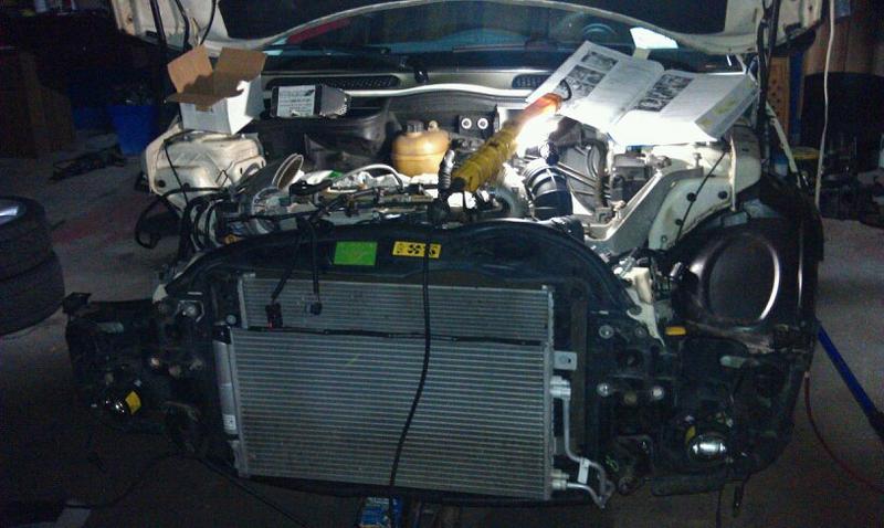

Bumper cover removed. MFE will stay on, Bentley recommends just supporting it with a couple M8 x 100mm screws

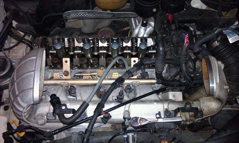

Cam removed, to be sent out for a custom regrind- 264/272 (I/E)
Empty engine bay actually looks enormous now

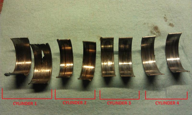

Let this be a warning of the damage oil starvation can do. Pic below is of the rod bearings from my old motor.
Suffice it to say I will be checking my oil religiously from now on
