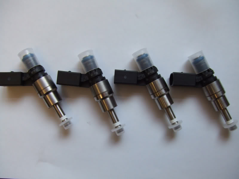

Here is an image of the VAG injectors:

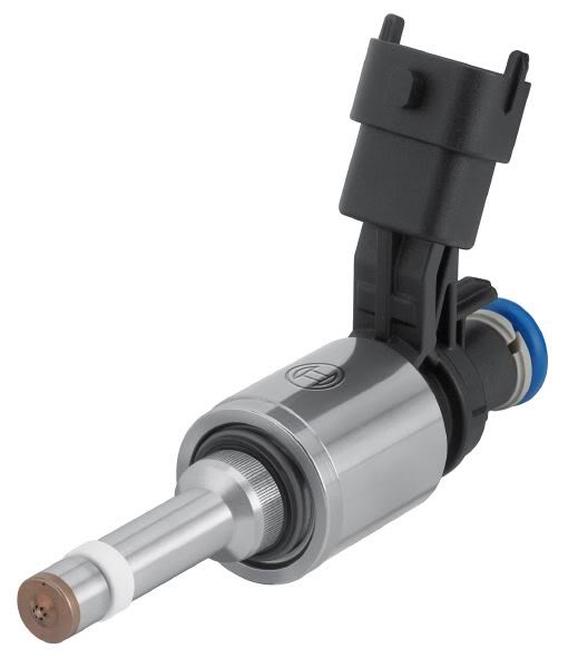

And here is the image of the Bosch fuel injector body style as fitted to the BMW MINI, albeit this is 1 of my racing high flow injectors.
Notice the outer case body styles!

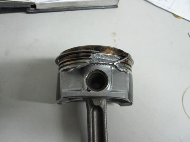

what exactly was the nature of the pistons' failure? Were they scorched? As in, excessive EGTs?

All failures I've heard of/seen look exactly like these, mine included:
Those are not of mine, but the last pic is from mine...and as you can see from the piece, it failed the same as the others. Found that in the oil pan.

They will all fail as per the images above ^^^ this un-shouldered section is the weakest point of the piston!

At least as you said, numerous. Very rare picture for mahle pistons. What AFR are you running? Do you have any dyno from your current set up of 18psi? If you don't, tell me your guess about the hp and the torque.
