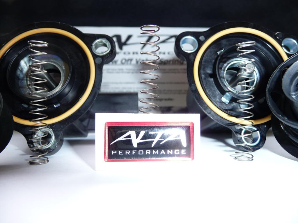

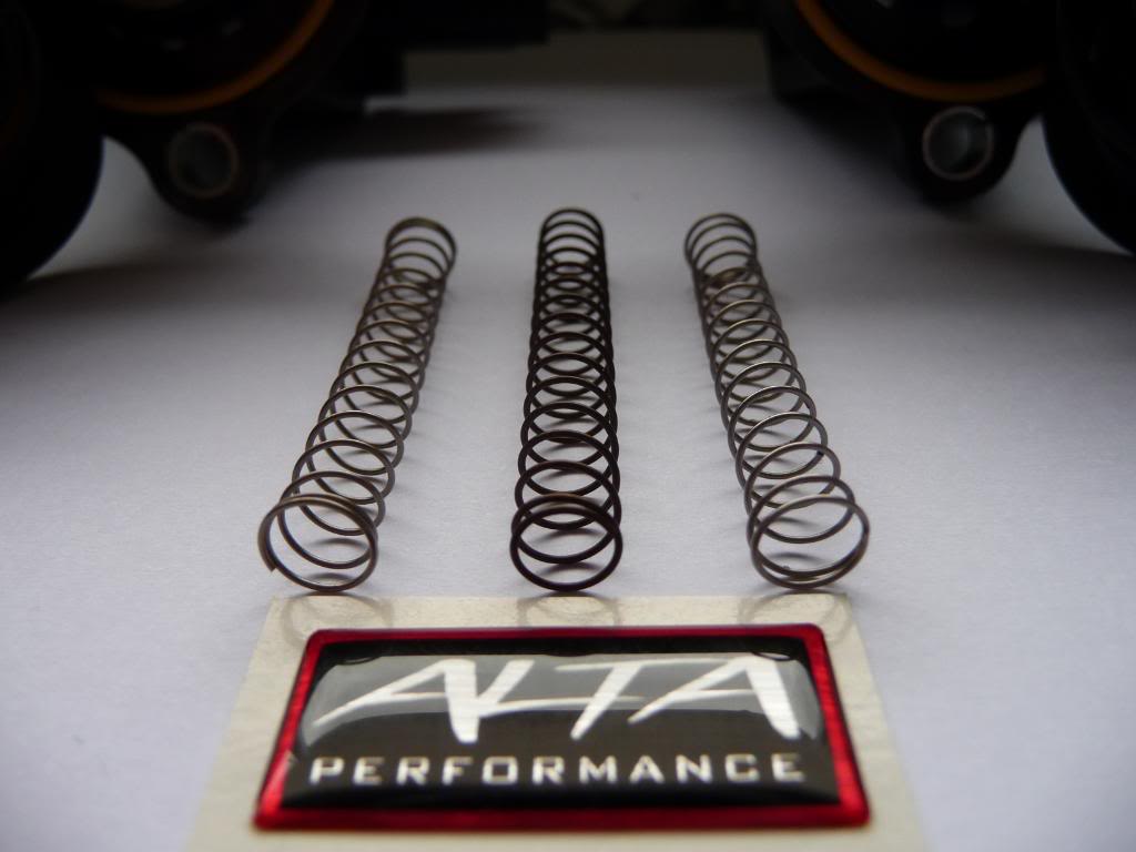

Ok guys, having now had the ALTA uprated spring on test for a few weeks now, I have nothing but good news to report back from my test findings.
Firstly before I did any installation I did a spring rate pressure, coil count, coil bind and weight comparison test on the ALTA spring VS a new stock spring, and the VAG recirculation valve too, and although I have the test result figures, I promised ALTA I would NOT publish these figures, sorry.
However the results as I'm sure some of you are now aware of, speak for themselves, as do the results for the VAG valve too, so for the purposes of the ALTA spring test, I will leave out the VAG results, as that can be found in another thread.
After all the testing was complete, I first installed 1 of ALTA's uprated springs into my 2009 factory stock Clubman Cooper S, now before the install
of the ALTA spring, no matter how fast I shifted into 2nd I could NOT introduce any break in traction or interference from the traction control aid, on a warm day on the dry test track.
Once I had installed the ALTA spring, on the very first test run, as I shifted into 2nd gear I immediately experienced a break in traction, now don't get me wrong this was no tyre shredding smokey rolling burnout wheel spin, however it was nonetheless a break in traction, and no matter how many times I launched and shifted fast into 2nd gear, I got a break in traction every time.
So bring on my 2010 Countryman Cooper S all4, again factory stock, now again no matter how hard I tried when shifting fast into 2nd gear, I have never managed to break traction, on a warm day on a dry track/road.
Now although my Countryman has the latest (N18) engine, the recirculation valve is exactly the same as the 1 found on the (N14) engine!
With the ALTA uprated spring installed, I had many practice launches whilst shifting as fast as I could into 2nd gear, and although I could feel the positive difference, I could only realistically manage a slight churp from the front tyres as the onboard computer did it's level best to limit the slipping grip.
Now what about normal driving situations, well with the ALTA springs now installed in both of my factory stock cars (2009 Clubman Cooper S and my 2010 Countryman Cooper S all4) I have and do notice a positive difference in the recovery speed of the boost between every gear shift, and the increased duration of holding boost throughout the upper RPM range.
What if you have a tune and have increased boost pressure, will the ALTA uprated spring for the recirculation valve still offer me a benefit ? YES it will, I tested this theory out on my 2009 Clubman Cooper S, and although it is factory stock, it is also my development/test vehicle too.
I therefore on the initial test day, installed my intercooler, my air filter, and tune, which increases the stock boost pressure to 19 psi AMP allowing for the overboost increase of 2.1 psi which is only available for approx 12 seconds at any one time!
Those of you that are running more than 19 psi AMP will be experiencing boost cut from the overboost facility cutting in, but more on this subject another time.
Anyway back to the ALTA spring test on my now modified and tuned 2009 Clubman Cooper S, although I and some of you reading this will have noticeably more power, there is still a positive overall difference between the ALTA uprated spring and the factory stock recirculation spring.
The ALTA uprated spring still managed to hold the increased boost, provide a faster recovery rate when building boost between shifts and hold the boost duration further into the RPM range, just as it did on a stock engine.
So all in all, I give the ALTA uprated spring for the factory stock recirculation valve a YES and a worthwhile mod, however the only negative I can see is the initial purchasing cost of $24.99
The VAG valve is on the right in the image below.
Notice that the BMW Mini spring on the left is exactly the same as the VAG spring which is on the right, and the ALTA spring in the centre in the image below.
