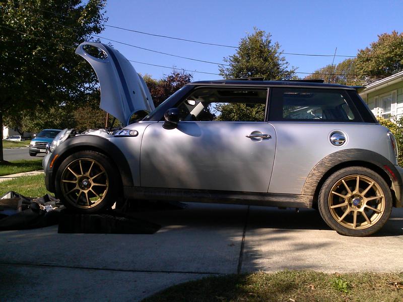

Pics uploaded show: 1) How I created space to work 2) Rhino ramps worked perfect (for installing NM Engineering torque arm insert...unrelated I know) and 3) Even more unrelated- the interior of my mini lmao.
