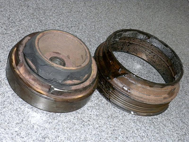

I found the problem! It was the crank pulley. I'll bet you'll never guess how I found out. Ok, maybe you did.
I was driving today and all of a sudden Boom! Clank, clank, clank ect. I pulled over with an overheated engine and lights going crazy. I popped the hood to find the belt came off. Not only was the belt off but the crank pulley was laying on it's side between the block and the engine compartment. The crank pulley completly came apart.
The only visible colateral damage I can see is a tear in the cv boot which I can replace without a problem. Has anyone had this happen before? Do you think there will be any other damage internally?
I still need to pull the remaining piece of pulley off of the shaft. I think I will need to use an impact wrench to do so because I can't stop the crank from spinning even when in gear.
Any comments or suggestions? New pulley suggestions?

I used an impact gun to bust off the bolt, then a regular harmonic damper puller to pull it off. I would suggest an ATI Super Damper over the redesigned 05/06. Spend a little more and have some peace of mind!
Well, I had to get the car to a place to park it si I drove about a 1/4 mile before turning it off. Do you think there's any damage?

Hey Chad, took some pics of the OE pulley, I removed to send..... too late....
The replacement? I believe the engine is pleanty safe with a light weight 0, +2. The crank is short, just slightly over square, 3.38" bore & 3.03" stroke. There are pleanty of old, heavily abbused, still onthe road, SBCs with a stamped sheet metal "V" pulleys... The replacement available, in 06, for this , my, car was the OE 06 or a light weight aluminum.... post 30 this thread.

I got the pulley / balancer off without a problem.
Now I just have to find someone to get me a new one fast. I ordered a half shaft this morning and will have it by the end of the week. I decided to go with the half shaft over just the inner boot because it only costs about $30 more for the entire axle assembled and ready to go with a lifetime warranty. If you look at the pulley you will see a sizable ding in the edge. I think that's where it hit the axle. I can't see any damage but there may be some under the inner boot or the joint itself. Better safe than sorry, right?

Good deal on the half shaft, true, better safe than sory... not to mention your time.
Now that you've seen the OE piece, it's pretty evident how it could fail...

Yes, after seeing the factory pulley it's clear that it was a poor design. Too much of a weak link between the pulley and the balancer.
