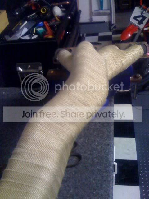

Old Mar 28, 2010 | 01:46 PM
JIMINNI's Avatar
JIMINNI
Joined: Nov 2006
Posts: 4,862
From: Fresno Ca.
Old Mar 28, 2010 | 01:54 PM
JIMINNI's Avatar
JIMINNI
Joined: Nov 2006
Posts: 4,862
From: Fresno Ca.
Originally Posted by R53
Jimmini, i wouldnt mind the more technical explaination!
Judging from the lack of responses, is it fair to say that this mod is not done by the masses and contrast to that its not worth it?
PMed you

"THE WRAP"
Jimmini: THAT IS BEUTIFUL !! One question:do you keep a shield by the power stearing pump ?? I've heard conflicting thoughts----I don't know why a guy wouldn't (insurance) but then YOUR job--------WOW !! I wonder if there IS someway to "failsafe" the material ?? Anyhow--I know some Italian net fisherman who'd like to talk to you !! heh heh--REALLY NICE
Old Mar 28, 2010 | 06:44 PM
JIMINNI's Avatar
JIMINNI
Joined: Nov 2006
Posts: 4,862
From: Fresno Ca.
Well.....that is not mine I can link you to who did it He is not on NAM anymore I posted those just to show what can be done

Old Mar 28, 2010 | 10:18 PM
R53Warrior's Avatar
R53Warrior
Joined: Aug 2009
Posts: 452
From: PDX
that looks almost identical to mine
