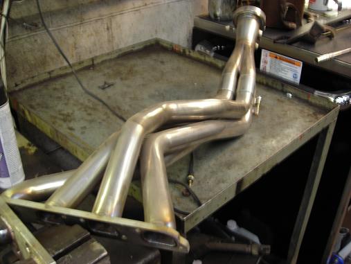

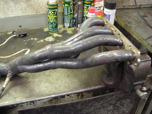

Today we installed the RMW race header with high flow cat, It Makes a differnce compaired to my old $140 OBX with stock cat. the sound is very noticable in the upper RPM ranges.The exhaut flow it grately increaced

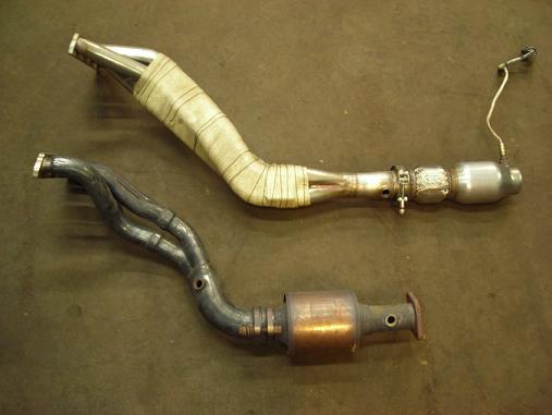

Congrats .
Here is the mother of your header . Still on my cars after thousands of problem free miles.
Longboard

Yeah its NICE...... Longbord is the header your showing for the 1.8 rotrex car ? it looks very close to the to the other one. We are curently installing a 1.8l rotrex motor in one of our race minis. you can see the differnct in the headers..SWEET ..... 14 Weeks till first track day :0

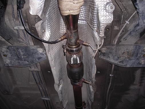

Nice. So what'd you do? Cut and weld that Borla cat-back? Did you extend the 2nd o2 wires? If so, did you use regular electrical wire or thermocouple wire?
Old Mar 2, 2010 | 07:01 AM
lowmini's Avatar
lowmini
Joined: Jul 2008
Posts: 35
From: Ottawa,Ont, Canada
The borla needs alittle trim but it all fits. it is a longer unit, Jan sent me a 02 extension wire it has factory conections and its protected just like a OE wire, for the front o2 if you pull the the rear wire from its fixed location you will see that it is longer and reached my cat.
The pics are with out the res pipe. i took it for a drive and dam it was loud...and i would not pass sound test for track racing ...... so you can see the flang i put on the cat with that little pipe on it. thats were the res pipe just fits in. You have to flip the center exhaust hanger and cut a pice out of it so you res can but up to the Borla's center clamp.
I ill take some more pics with the res pipe installed.. Sound tested at 89 db with high flow cat and res pipe installed Still leagle limit is 96 db
