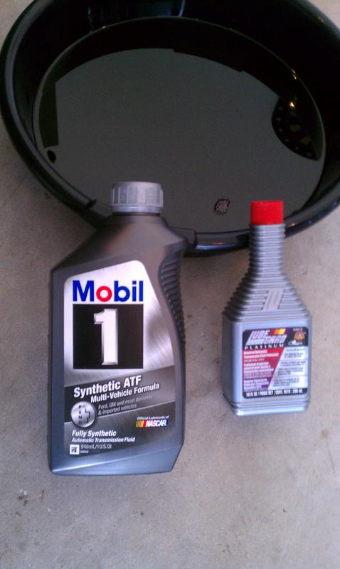

Got 5 qts Mobil 1 ATF and the LUBEGARD Platinum today and will change tomorrow. Could not get it done because I spent all day looking for the crush washer. Already changed plugs, light bulb, and cabin air filter. I found no gasket leak. Can't wait to have my mini running strong again. WIll let you all know how it went. Thanks again!

Done with 1st Drain/Fill

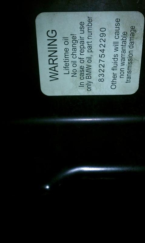

Done. 50% better. Really wish I did this earlier, 'cause the Mini really took a beating while I believed the "lifetime fluid" hype. Hoping I can get it back. Attaching some pics of the Mobil 1 ATF fluid, some lubegard, my used ATF (got 2.5 qts out), the laughable "lifetime oil" sticker with scary warning, a pic of the drain plug location, and all the parts involved...
Attached Thumbnails MCSA Tranny Fluid Change-imag0471.jpg   MCSA Tranny Fluid Change-imag0469.jpg   MCSA Tranny Fluid Change-imag0470.jpg

Do not use additives. They are useless and can potentially cause issues. The M1 synthetic has the additive package you need.

No additives? OK. Gotta do a second drain/fill. Trans was flawless for a day, then reverted to same dropping into/outta gear and slipping issue, but overall 50% better. When I get the fill plug out, will check the thread and post...

Lubegard worked for me.
How many miles have you driven since the fluid change? One thing I would have recommended, since you were having shifting issues, would have been to buy the Toyota T-IV fluid to use as your flushing fluid, after a couple of cycles start using synthetic. As for the lubegard, it sounds like your transmission is starting to do what mine was doing. After almost 1000 miles of fresh fluid in the trans, there was no change in the behavior. I drained the fluid again to add Lubegard Red, after 100 miles, the transmission was considerably better. There is still a stiff 3-2 downshift at times but it went from almost completely undrivable to being able to go out and play. I'll agree that the vast majority of additives do not do what they advertise, but the Lubegard worked for me.
