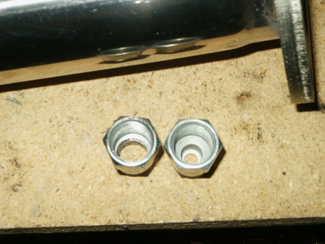

Just get two spark plug non-foulers from Autozone and stack them together. About $3 for two if I remember right.

Old Oct 4, 2009 | 07:48 PM
+1 thats what I did

You need to drill out the top one like this...
Assemble, thread in O2, and you are done.
I have no idea why others haven't been using this. Its cheap, and it always works.

huh!?! What is that exactly doing? Does the o2 censor not fit in the bung properly that you would need to get those two spark plug non-foulers!?! Im a little confused.
It moves the sensor out of the exhaust stream, but still heats up the sensor.
