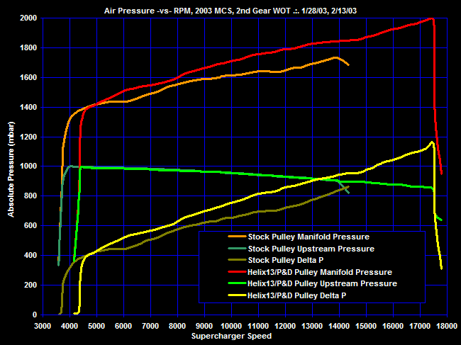

Casey, I bet I have you beat for blower speeds - I've seen 7691 engine RPM at the dragstrip (special chip) with my 15% pulley for a calculated 18,639 blower RPM. Here's an interesting chart showing air pressure versus blower speed:

Tthanks for posting that graph. It looks like the boost just continues to build - I would have expected it to start dropping, but I guess the supercharger is more efficient than I thought. I wonder what kind of power was being made as a result of the likely increased intake temps....

Well, the supercharger will keep making boost as it is spun faster, but the issue becomes heat. Some of the boost is due to increased air temperature rather than a greater number of air molecules. At WOT, from 2k to 7k rpm, intake air temperature can easily go from, say, 90 F to 160 F. Since PV=nRT, the absolute change in temperature will be proportional to the absolute change in pressure, if all other things are kept constant.
For temperatures in Fahrenheit, you need to add 460 to get temperatures in Rankine.
So, look at a change from 550 to 620 Rankine, it is an increase of about 13%. So a large amount of that boost especially at high rpm is really due to heat, not additional air molecules.

Ahhh, that's what I figured. So you really do start to see diminishing returns at those levels of boost.
As mentioned earlier by others, it appears the real benefit of the 19% pulley would be to shift the powerband to lower rpm's, not to really increase the top end. It would be cool to see some dyno charts...
