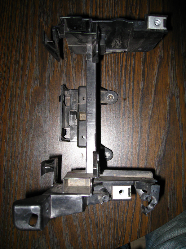

OK here we go. This is the way the bracket looks from the top:

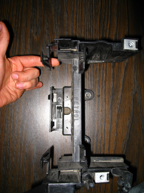

There are two plastic tabs that you need to push down firmly at the same time, and pull out the ECU with even force to get out of the bracket. It will slip out of the bracket with little resistance if you're pressing the tabs down far enough. My fingers show where they are when viewed from the top:

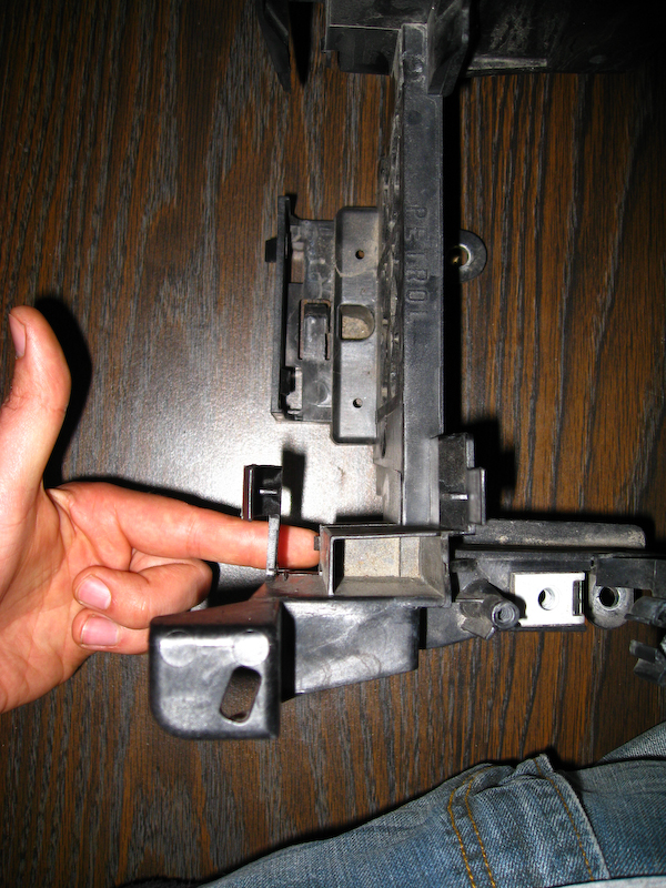

Here is a side view to help you see what's not visible when you're working on removing the ECU. My fingers are pointing at each tab:
