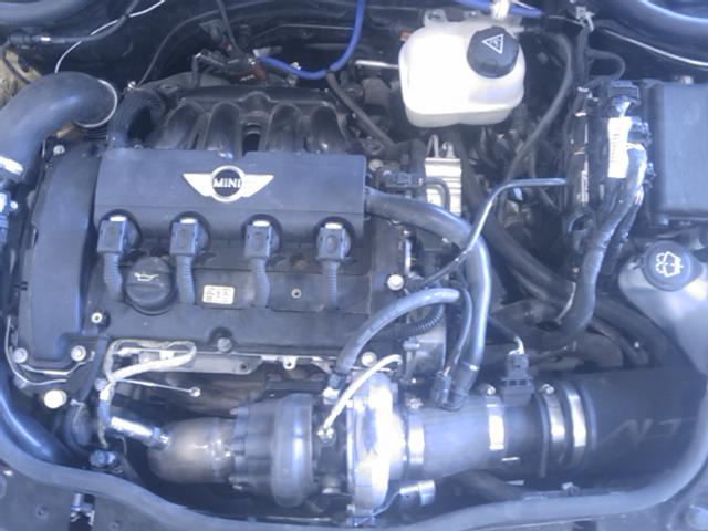

hey just installed the atp kit -not a drop in. anyway i posted this somewhere else, but how did you control boost before the electronic one. the kit drops boost and i can only produce 8 psi. Runs like crap though it sounds nice. I changed a few things as to where the intake sits.
Attached Thumbnails GT 28 RS - all parts ready to go :)-image_064.jpg

Nice setup. My car ran the same at first without any boost controller, and now with the electronic one i havent tried upping the boost so i set it to about 11/12 psi and will leave that to my trustworthy tuner come custom remap. I also set the gain so i get better response from the turbo and im quite amazed at how well the car goes for 10 psi, needs a proper tune/setup and alot more boost though
What bov are you going to fit ? Are you planning on making a sealed box to surround your intake as that would be the perfect intake if you closed it off

Hate to be the one to say it, but didn't you give something like that any thought before you went ahead and threw the kit on?

redo the intake the mass air is way to close to the turbo you are getting a lot off false reading to the maf sensor i already tried that and getting a lot problems

No, because I know it may take time but it is the best way to get some big hp out of the r56. Its all for fun anyway otherwise why do it. I don't have a bov yet and was not going to close off the intake because it looks cool this way and should not be any more open than if it was in the back. I am working on a tuner but they are so busy this time of year.

Hey you were right I unplugged the mass air and not the car runs smooth and nice - and oddly enough no engine light any more.
