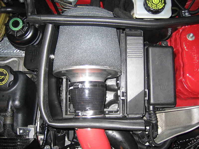

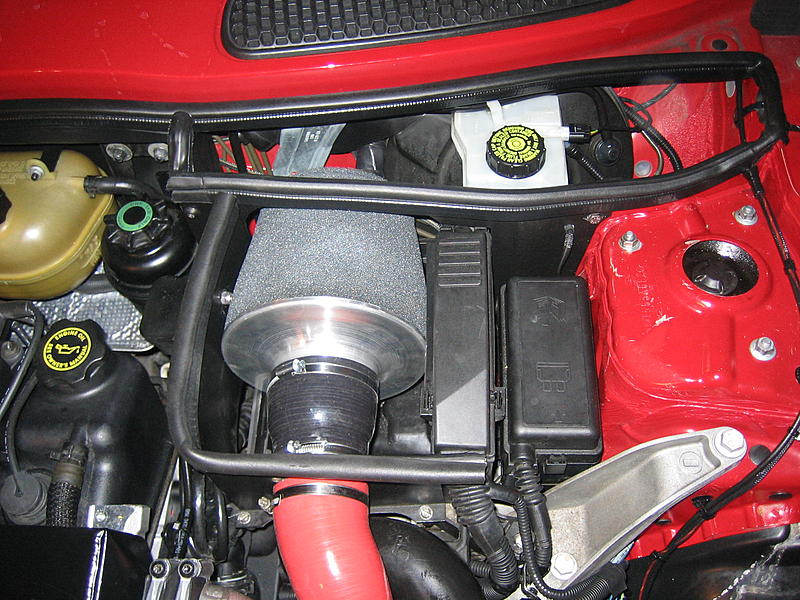

So I decided to get a new filter for my intake cuz the K&N was 5 years old and I always like the itg filter that came with my intake on my old car. So I order a filter and intake tube and then the filter that came was to small, so I returned it and go right to itg and order a new ''BIGGER'' filter. I new it was big but WOW. It flows good, sound great,the shield needs a little modification but it should be no problem. If the shield does give me trouble, one of my friends/fellow mini owners is itching to fab an intake shield out of aluminum.

THAT is a fatty! =]

holy cow!
too bad bigger filter doesnt mean more air into the engine.
looks decent though.

Cool, I built something very similar. Best thing to keep in mind is to "seal" out the engine bay (heat). I rigged up a heat probe and the best material for heat soak was the stock plastic. Once the car car was moving any of my experiments (inside the CAI) cooled off quickly no matter what material. So the more sealing out the heat the better. Looks good.

You may want to rethink that filter - a fair portion of the filter is jammed up against both sides of the housing and that means no airflow, so while a bigger filter theoretically means more airflow, in this case I think you are actually hurting yourself.

I think you're good for airflow even with the bumping against the sides, that thing is huge!
Only thing I'd consider is rain soak with the filter coming up under the open grate beneath the window, perhaps fab a small shield there.

DixonLS its does look like its all up on the sides buts its not as bad as it looks, also I have a friend who is masterminding a new intake shield from aluminum or plexi or stainless or some other space metal

Just a question: have we ever heard that CAI filters like the Alta or the DDM or M7 or similar don't flow enough air?
There are threads too numerous to count in which it's made pretty clear that the problem with the intake charge on the R53 is not air, but fuel, especially as you start spinning the SC faster and putting cams/heads/headers etc on. Yes, the stock MCS runs pig-rich, but that's not due to the air filter--that's an ECU map problem that gets fixed with a custom tune. Even cars putting out over 250 whp don't have breathing problems with smaller filters.

The bottleneck is not the filter, its the plastic tubing between the supercharger and the butterfly.
