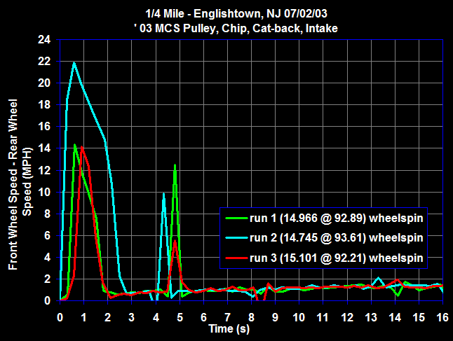

When comparing the Azenis to the Hoosiers, they are definitely superior in the cold, but you are totally correct when talking about the overall performance of the tire. It seems that the Falken is best at about 115F tire temp, while the other "fast" tires seem to like quite a bit more heat. After about 5 laps in higher ambient temps - above 75F - the Falkens get pretty greasy.
Out of curiosity, how do they work at the drag strip?
Randy
Randy
The carcass on the Azenis is so stiff that lowering front tire pressure appears to have little effect on contact patch. In fact, launching hard unloads them to the point where I doubt there is much contact patch left at all! This is what the wheelspin looks like:
