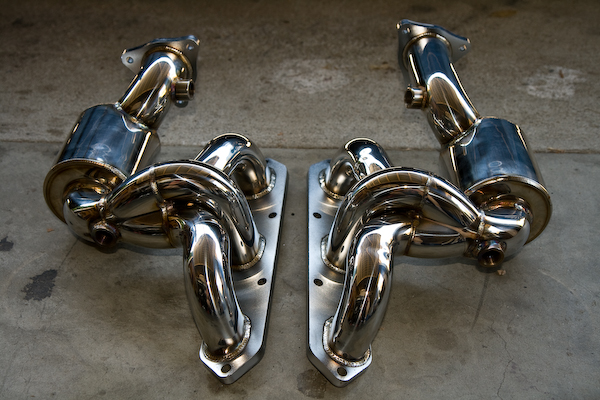

I have to concur with ^. Very interesting thread as it hits home w/ me. The drone on my Boxster is awful. Headers, sport cats and dual free flow mufflers minus the OEM cross over design = a very short exhaust length and terrible drone that vibrates the entire car at highway RPM's. I wear earplugs if I have to drive it for extended periods.
The headers were shiny though

I wanna sleep with those headers, they're so beautiful.
