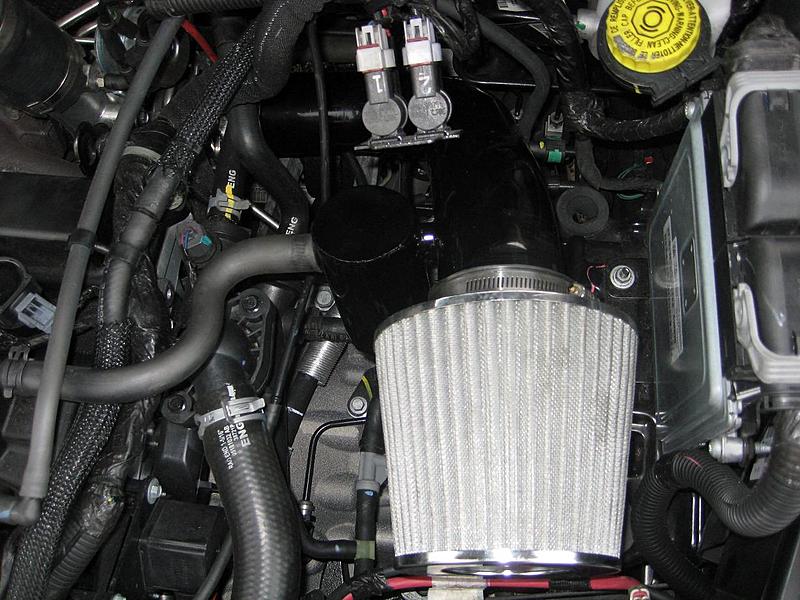

Here is a first. I made my intake with a built in catch can in it. I put chambers in it so the oil does not go into the in take. There is a drain on teh bottom.
