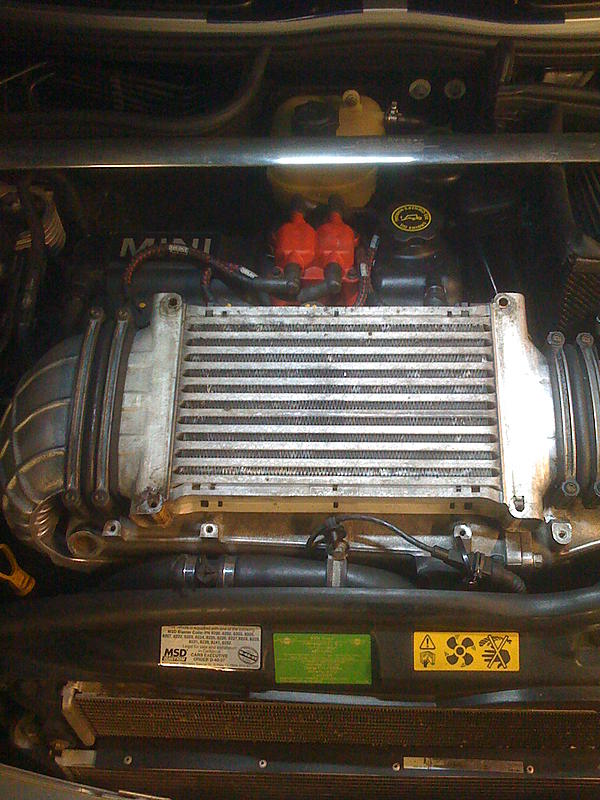

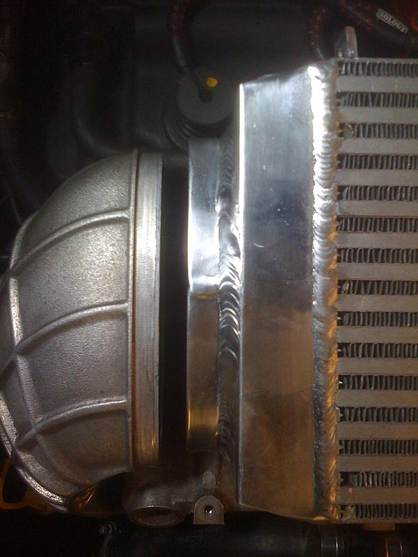

I bought this intercooler about 3 weeks ago, had it installed on my car. It requiered some work and triming. It is not a straight bolt on to say the least, but I guess for $199 it is a pretty good deal. I actually have some pictures that I could either email you or post here on NAM. I just need to find out how to do that. Please be indulgent this is only my 2nd or 3rd post. Give me some time.

That sucker was NOT made for a MCS! Look at that displacement of the inlet and outlet couplers...oops. The weld quality on the inlet doesn't inspire me too much either, especially if you're looking for a good seal to avoid boost leaks.
Try again...
