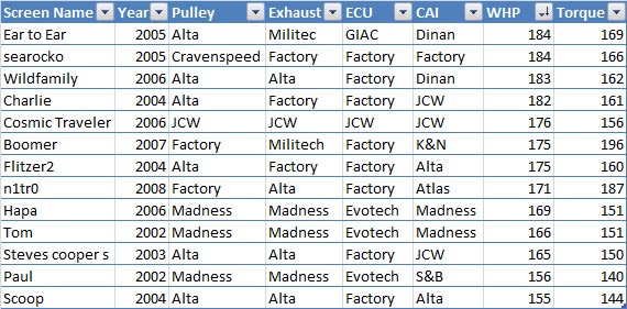

So at the bottom of the page you will find a overall results list of the Dyno Day that PS Mini did back at the first of May. You will note that Scoop is at the bottom of the list at a 155 WHP and 144 torque. Scoop had a seriously worn out supercharger belt which caused this problem. Scoops numbers to date with a new belt and a Jan tune are as follows.
NAM User: scoop
My configuration:
2004 MCS
Alta CAI
Alta Sportone exhaust
Alta 15% pulley
Stock injectors
Stock plugs
Initial pull:
155.4 hp @6700 (May 2007 at PSMINI club event)
150 torque @ 4000 (May 2007 at PSMINI club event)
Jan Tune event pull
185.8 hp @ 6900 (6/20)
171.3 torque @ 3854 (6/20)
Final pull
198.8 hp @ 7200 (later adjusted to 196.2 with better A/F balance)
173.2 torque @ 4027
Total gain
Horsepower: 16.9%
Torque: 1.9%
Okay as you look at the bottom of the chart you will find 3 Mini's with EvoTech Tuning and other Mods pulling stock numbers. The question I have asked over and over is why are these 3 cars are pulling stock numbers. This along with Pure 13 and Safety Sean are all showing what I would call less then acceptable number in relationship to green backs forked out.
Now it is nice to know that Dimsport can't read EvoTech DAHHHHHHH it is called it is called security coding. But both programs can read BMW's EUC and if you know what the stock program looks like you can see that the files have been changed. You can't read those files unless you have the same program. Further more if the file for the DSC has been changed I doubt likely that fuel pressures are in that file or that if the rev limit files change the timing. If you want to play word games I had my Mini ECU tuned because I went down and had the driving light function turned on at Mini. What we are taking about is a performance tune and what is involved in that process.
In closing I have asked for going on 2 months why these 3 cars did not perform as claimed. I do not care to here that it is because of global warming, bad gas, flywheel numbers not whp, that it is an automatic, or even because the ambient air temp and no fans, none of this accounts for 30 HP. Pure 13 and Boomer raise a question as in what I am I paying for and as consumers we have a right to know. To date we have only had one company state what they tune and that was done with in 3 hour of the first post.

It's not clear to me why you are calling the numbers near the bottom of the chart "stock numbers".
155 whp plus 15% losses in the drivetrain is about 181 in the engine HP that MINI quotes for an S (165-168 depending on year).
15% losses would make stock power about 141-143 HP at the wheels, so even with whatever is costing power on Paul and Scoop's cars, they are still getting 12-15HP over stock.
I think it is clear at this point that EVOTech is tuning the cars as they claim, but that Jan doesn't understand what he's looking at when he tries to use Dimsoft software to interpret EVOtech code. This is software folks, and tables and code get moved around.

Well if Evotech is tuning to their claims, then based on those chart results, the factory map kicks ***. Heck, my car pulled 184hp with just a pulley. Going by your 15% drivetrain loss correction factor, that's roughly 216hp, equalling the MM Stage 2 kit for $1900 less.
But the question remains, people are spending big bucks on these performance packages but when dynoed against others on the same day, same dyno, same fan blowing at the radiator, etc., the numbers fall short. Sure, factors like gas, engine temperature at time of pull, ambient temperature, different driver stepping on the gas, phase of moon, etc... may cause part of the variation, but when you have cars with less mods literally blow away those numbers, something is terribly wrong. The chart shows THREE examples of Evotech cars falling short. So far, there have been no answers, just excuses.
I'd call it more likely that the 12-15 HP is the pulley, intake and cat-back plus the tune, and minus whatever is costing a bunch of power - which could be a lot of things.

Well, there is one really easy way to put this all to rest. Take any of the evotech cars that have an evotech tune, go run them on the dyno, reflash them back to stock and run them again. Then there will be definitive data for everyone to see what the merits of the evotech flash are.
Any takers? I bet with as heated as this is there would be enough people willing to pony up money to make this happen in a heartbeat.
Uncalibrated dynamometers are useful for comparing before and after changes or between cars on the same day. Period.
The absolute numbers that come out are totally meaningless, unless the device is calibrated and certified recently, and even then, only if temperature, barometric pressure, and the heat-soak state of the car are both controlled and stated.

And again, like others have said, 12-15 whp is coming from a pulley, not the tune.
And then as Rocko said, if the dyno was reading artificially high, then the Evotech cars are even worse off (take 10-15 HP from them).
He has a strong car, lots of people do.
For what it's worth, the 05-06's (From what I've seen at least) appear to be better built than the 02-04 motors. The coated SC's help quite a bit with heat, and the internal tolerances are tighter.
My suggestion has nothing to do with uncalibrated dynos or ultimate numbers. The runs would be ten minutes apart(as much time as needed to re-flash) on the same dyno(we're looking at deltas only) same day. Again, we will see very quickly the merits of the evotech tune.
As for people rhapsodizing about dyno numbers, until you come up with a better, standardized solution for comparing performance data, we are stuck with what we have. Without dynos, you'd be left with 1/4 times, lap times, and top speed data. I think the dyno data is a nice addition if not perfect.

As I expected very little positive input or answers into what different tuning companies tune in your EUC. Just spin and blame.
Thank you SeaRocko
Big Howe your right that is what should be done with the EvoTech cars. But there should be no expense.
Thanks Rusty Boy, yes depending on the build and if World Cup is on the stock pulls range between 140 to 165
Thank you SeaRocko

there are other changes but none in the MAIN TIMING map or THE MAIN FUELING..... which would explain why the HP wasn't there.
I have downloaded earlier tunes of EVOTECH from other unhappy people and I can tell you those maps had major timing advances in the main map. Why did they go away from using the MAIN TIMING AND FUELING MAPS?
