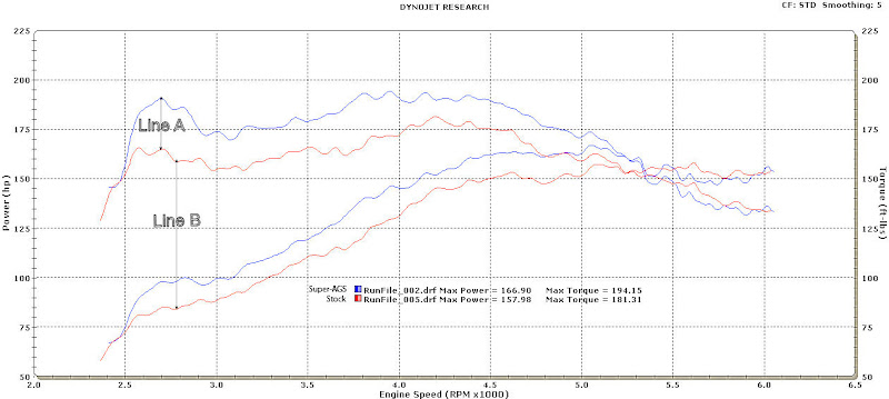

Randy:
After five minutes of squinting, It looks in the range of 20 or so.........regardless of other people's supposed agendas, even a 15 ft-lb. increase would raise my eyebrows.
Were there multiple pulls done? If so, did they also show sizeable gains between 2500 and 2800 rpms?

Before a war of words is started...may I ask this please.
Can the sheet be recreated using say Red/Blue for the Super AGS run and 2 contrasting colors to the Red/Blue for the stock run.
I think with both runs being the same colors there is a bit of confusion as to how all this is to be read.
I drew 2 lines on the existing graph above, A and B
What is being compared. Is A the delta or is B the delta.
Seriously? A is the torque delta B is stock HP and torque. Look at the graph, there's a key.
Yes, seriously..I'm old and this is small stuff to see. The lack of contrast between the lines exp in the 5-6k RPM range confuses me. I'd imagine others are having similar issues seeing the differences with the way the data is provided.
No conspiracy here...just trying to make it an easier to read tool for all.

Originally Posted by maxmini
After blowing up the graph even more the delta at 2800 is indeed 15 not 25 as Rustyboy originally posted. Must be that new math In any event the colors were unfortunatly chosen by the dyno operator and not by us so we are stuck with them at this point.
Randy
M7 Tuning
You may want to check that again. I see a gain of about 25 ft/lbs at both 2700 and 2800.
Randy
M7 Tuning
my question about the graph is up top about where tq and hp cross. it's hard to tell which line is which after that (before below after or after below before)
I agree with you . Was not our choice .
It looks like the stock torgue at 2800 is about 85 or 86 and with the AGS 99 to 100.
Randy
M7 Tuning
Torque is the top 2 curves hp is the bottom 2. Look at the key.

yeah, we got that. that's not what I'm talking about. red touches red and blue touches blue (or maybe crosses it). Gnatster asked for a new graph showing four color resolution, not two colors as shown. As Randy said, not possible.
cartar was referring to the fact that Randy was accidently reading the bottom curves as the tq curves rather than the top curves.
I agree though....using the same colors makes it a bit hard to read when they overlap. The dyno guy should probably rethink that

Randy:
It's more in the range of 25. At roughly 2700 rpm, I'm getting about 165 stock and 190 modified.
Again, not to be a broken record, but it would help to see the second and third pulls to see if this is a trend or an anomaly.
It is in the 25 range (a little more it seems) at 2800....I threw it into a graphics program and did the measurements to just check it out.
You are correct. I am so used to seeing my low torgue figures I thought the higher of the two were HP. Good pickup. I will remove those posts .So now we are back to the 25 ft lb gain at 2800. Well we all know dynos can never lie so it has to be true.
