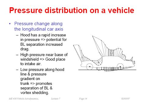

i was just studying for my vehicle dynamics exam tomorrow and came across the following lecture slide (see attached)
figure is from:
Gillespie, Thomas, Fundamentals of vehicle dynamics, SAE Press, 1995
where does the idea/logic for the mini having low pressure at the base of the wind shield come from?
i know it is a general car being spoken about so there might be a reason for the mini to be different...
figure is from:
Mis-thought reasoning behind velocity & pressure?
Pressure should be highest at regions of little air movement...supporting your slide. Lowest at regions of quickest moving air.
I myself could never figure where that idea came from as well. I have seen wind-tunnel models where the air flows and velocity are, but never much mention of the associated pressure impacts.
Even seeing the above image (posted by 101101 above) shows that velocity should be highest near the front ridge, top, and backside. The orange/beige color, if my eyes aren't off, seems to be well on the positive pressure (low velocity) side of things...an area also covering the scoop location. Seems to go along with your data as well, UKCoopeR.
- Matt

It's a good book...
figure is from:
the general idea is that the total pressure is pretty much constant as close as a few inches to the car (couple places that this isn't true) so there is a trade off between static and dynamic pressure. So areas where air goes faster, the static pressure is lower. This explains the low pressure over the top of the hood where the air is really moving, and the higher pressure where the verticle surfaces "block" the air. The points about flow separation has to do with the angles of the surface relative to the flow direction, and can cause turbulent flow the drastically increases drag.
Back to your normally scheduled thread.
Matt
ps, it is a good book, but a bit of a dry read. Lots of good no-nonsense info, and the math isn't too bad. I think it's about $70 though... It's nice to read stuff like it, as you get good info, without having to wade through the noise usually present in internet threads...
Matt
so because the mini windshield is so steep this slows the air velocity down alot and we should have access to a higher pressure than a more swept back/standard car right?
how tall are these scoops? i don't have one myself... also my intake in is lame r50 land lol
yeah i liked the book too (the author taught the course the last few years (i go to UM-Ann Arbor)), i had to learn that one pretty throughly before even trying to read "Race Car Vehicle Dynamics by Milliken & Milliken" another fav of mine
