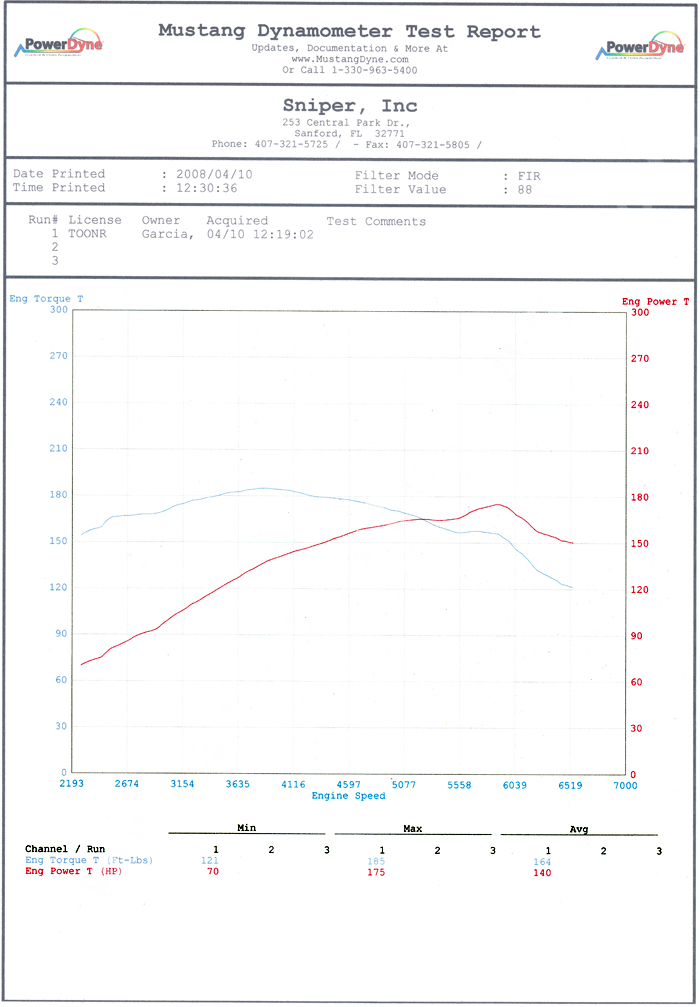

CHART ONE - This run consisted of running no nitrous through the intercooler sprayer. Very reliable, safe tune running an AFR in the high 10's at the start (2K RPMs) and finishing in the mid 9's at the end (7K RPMs).

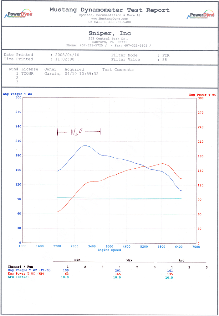

CHART TWO - Spraying the N2O for the first few seconds of this run lead to a huge spike in torque; a similar run as described better below produced 233 ft lbs of torque doing the same thing!

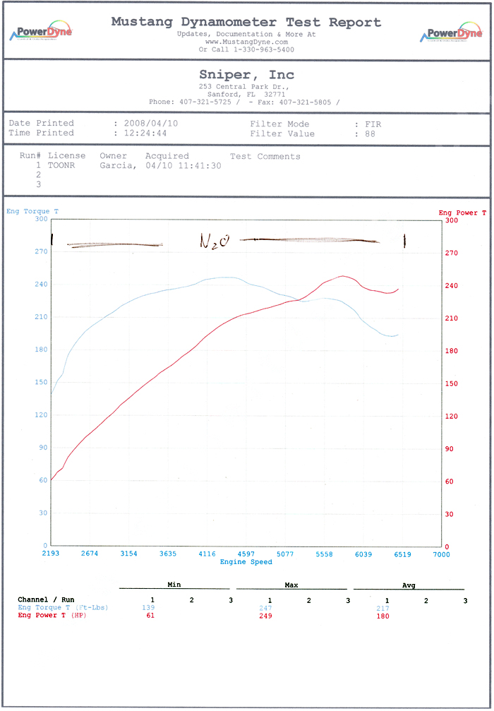

CHART THREE - Our end result for the day, and though the car was sometimes unreliable, it produced the highest numbers. The car had a bad idle, constantly revving from 500-900RPM, and timing during the run wasn't established as we had previously set it. This ECU image came from the developer of the software used to pull an incredible amount of data from my ECU image with hundreds more settings available then any MINI ECU tuner on the market today. So we couldn't trust this image to drive the car home from the dyno without combining data as explained further below, and was flashed back to the first chart seen above.
End result (corrected HP numbers):
249fwhp / 247fwtq / ~15psi high boost
The result of these numbers today is not yet our finished, polished, completed product. The data pulled from my stock ECU image lead us to a group of settings determining torque limitations, and once removed, the car became a torque MONSTER - at one point, pulling 233ft lbs of torque with only 189hp, unheard of with a car with just the work done to my car! John Estrada, the infamous name behind JESTR Tuning, know the world over in the EVO and DSM community, still has much more work to do to my image to essentially merge the reliability of the first chart with the power of the third chart. Once he comes through with that image, I am certain the car will put down higher numbers. And all this in 85 degree weather at 100 ft above sea level here just north of Orlando, FL! Imagine what this car would do running the boost it did in North Carolina!!!
The ECU has also been reprogrammed for no-lift throttle shifting and launch control. Still playing around with both settings on the car, but the no-lift throttle means I keep my foot planted on the drive-by-wire throttle, press in the clutch to shift, ECU senses clutch pedal depression and cuts throttle, and re-engages throttle when the clutch is released in the next gear. The next best thing to paddle shifting / SMG! Launch control keeps my car at a pre-initiated RPM when stopped and clutch depressed. Lowering it from a tire-smoking 4500RPM to 3000RPM meant I bog a bit before taking off, so we have to raise it to a maximum of 4000RPM I believe. These two programs are done without the use of any external components, JUST ECU TUNING!!!!

Please note again that I am NOT SPRAYING NITROUS INTO THE MOTOR, I am sponsored by DEI for the CryO2 kit that is only an intercooler sprayer. Nitrous in this case should be considered just the same as carbon dioxide (CO2) as it is only being used as a cooling agent and nothing more. We examined the ability for nitrous to be injested by the intake, possibly leading to these outstanding numbers, and though it is quite possible for it to happen, it isn't the case - the simple cooling effect of the kit accounts for around a 10-15% increase in power on all ECU images ran on the dyno.
The ECU program is coded by JESTR Tuning and Sniper Tuning. Google them as I'm not going to ruin this thread with banter about posting links for competitors. Please see above for the reference to the use of nitrous.

There isn't any listing in the ECU that "Limits torque" slap a twincharge on your car and out of the box (Stock software) you'll be making 290 lb-ft of torque. If there was some limitation (First off how on earth is your car measuring the torque the engine is making
) then how does that work?Some of us here have spent what you've spent on all the other stuff for your car (Sprayers, underglow, wheels, paint, etc) on engine parts alone, so if there's some "Easy" way to pull 50 lb-ft of torque out of my ***, I'd love to know about it
I'm quite pleased with my tuner right now, thanks! I'm not going for any record, I think the people on here with "World's Quickest ________ MINI" titles are a bit ridiculous at the very least, and I've not once done anything to this car for fame, recognition, or some silly title.
) you don't really have anything done to the car to add that kind of power. You've got an intake, exhaust, pulley, a coilpack (?) and 200 different gauges, lights, and pieces of audio equipment. To make 250 whp (On a mustang of all things) without a head is UNHEARD of. The torque figures you're putting down are also 40-50 lb-ft higher than any other 1.6 with the M45.Full blown turbo cars putting down 600-700 whp aren't making more torque than HP, i've NEVER seen a dyno that shows the car making more torque than HP, so I'm not sure how you're pulling that off.
FYI also 15 lbs of boost on the stock head with a 19% is pretty low. That means with a ported head you'd be at 13 or so (I put down 14.5 with a 15% pulley). I'm a little confused with the figures you posted because some of the data suggests close to 20 psi of boost, while other data is at 15.
Something is either seriously wrong with their dyno, or you've stumbled on the tune of the century

wait dont answer that.. .cause I have the answer for you... I have dynoed a 15% pulley car, with CAI intake, exhaust and sprayed the IC with NOS... it made 300 WHP! ...isnt that veeeerrd?! Let me see if I can find that dyno sheet....
I have also made over 50WHP with just freezing the IC... but while that's fun, it's not "realistic"

I stand corrected.... but the car WITH OUT spraying the NOS on the IC only made 225 WHP

We ran the car about 3 times with the ECU image portrayed in CHART THREE. All 3 times, it yielded similar results with the one posted being the highest. I am just as confused about the results as you are, actually more so with my 189HP and 233ft lbs of torque run I made because I have yet to hear of an MCS making those kind of numbers. We went back and forth for nearly 5 hours today trying to figure out how that fluke happened, but you don't see me expounding upon it because I chalked it up as just that - a fluke run. Maybe the dyno didn't pick up the rest of the HP on the run off at the end of the test as JESTR said might have been a possibility. Either way, the results we ran in CHART THREE were confirmed and consistent. If you don't know about the torque limiting settings in the ECU that's because you haven't found it - it took getting software from Italy and data cables from Turkey to get a 512kb image from the ECU whereas we were only pulling 32kb with the previous software.
