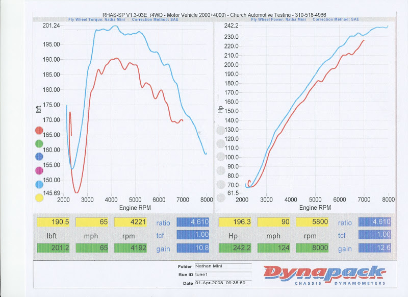

Yep, it's true, an honest to goodness 242 whp with 201 tq.
Where did it come from...the exhaust. Changed from the Stahl header and 3" back to the RMW header and exhaust.

Old Apr 4, 2008 | 10:49 AM
Intense's Avatar
Intense
252whp 200trq RMW style
Joined: Apr 2007
Posts: 702
From: Utah
Wow Nate! Very impressive indeed.
I had the pleasure of being there when the exhaust was being installed and I have to say that its a very very pretty system! Looks great and put together extremely well
From these charts its an amazing gain as well holy crap
Rob

Great numbers Nate That is a nice improvement for just switching exhaust. I guess Jan is not as dumb as some may think

Do you have RMW cam or non-stock intercooler?
What was ambient temp. at time of test?
Old Apr 4, 2008 | 11:44 AM
gnatster's Avatar
gnatster
Joined: Jan 2007
Posts: 3,952
From: Ohio
Cam is OEM MINI.
IC is GP
Mid 60's I think. The tune was preformed this past Tuesday, mid morning, in Wilmington CA. Not quite shorts weather but T shirt was comfy.

Nice going!! Your torque is really impressive. Has your car always been pretty strong for its level of mods? Did you "break it in" with a heavy foot? (really seat the rings well??)

some exaust "experts" will STFU about backpressure and learn that pulse velocity and scavaging is king! Too big is just that, too big.....

The bottom end is still OEM.
The car has NOT been strong all along. Jan and I have spent countless hours chasing demons on the dyno and before the exhaust swap I was not able to get above 180TQ and 230WHP. Once the Stahl header was pulled I knew exactly why we've been having issues. The flange was leaking at the #1 and #4 cylinders. Add to that the constant issues with gaskets breaking apart and leaking at the Flex/Cat joint. What I had been running was just to big for the car too. The Stahl was a 1 5/8" stepped to 1 3/4" primaries into cone tapering to 3" cat back. As Doc says above. Too big is just that, too big. BTW, the Stahl header is for sale, don't worry, it's been decked and checked to be sure it is 100% straight now.

That torque curve ROCKS.

this just in..............
Danny is at 266.7whp and 200tq on the second pull
Nate.... you ready for W2Air now?
