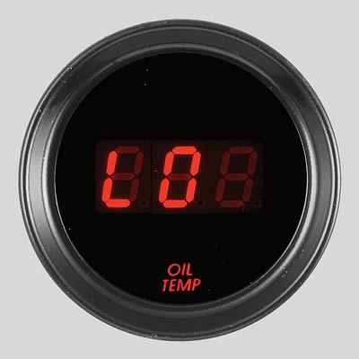

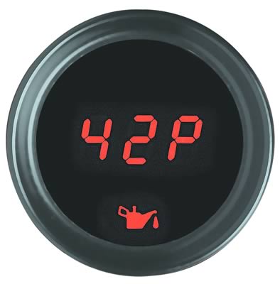

I have a set of these:
http://store.summitracing.com/........
I like the old school electronics feel to them. They remind me of something from Back to the Future.
