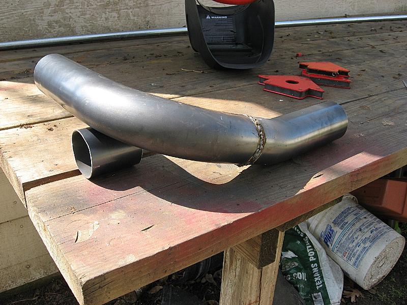

For all yall with fabrication skills you can make a one ball exhaust for $20. I have bought ALOT of stuff from Speedway Motors for my blown T bucket and was looking thru the catalog and they have a Tight Tubes Extention kit for running exhaust pipes from tight tube headers on hot rods. The kit is $40 but you can sell the other half for $20 (or whatever). Here is the kit from Speedway Motors: http://www.speedwaymotors.com/p/1722...nsion-Kit.html
I bought the kit and took measurements and determined I needed to cut 3" out between the two bends. The long exhaust pipe back from the catalytic converter is 2 1/4". The Tight Tube pipe as well as the original pipe from the resonater to the muffler is 2 1/2". I took the long exhaust pipe and the cut muffler to the muffler shop. I had the long exhaust pipe swaged JUST A HAIR BIGGER so that it fit tight INSIDE the fab'd 2 1/2" pipe. I had the cut end of the muffler pipe swaged bigger so that the fab'd pipe fits inside the muffler pipe. The muffler shop did not charge me for the two swages but I gave him $5 for a few beers.
I like the sound of the modification. I get no burlbing effect when I let off the gas as others have claimed.
Attached Thumbnails One ball exhaust for -exh1b.jpg   One ball exhaust for -exh2.jpg   One ball exhaust for -exh3.jpg

it's really not that hard. Just take good measurements and know where you want to cut the existing pipes. I placed the fab'd pipe into the reinstalled muffler, then inserted the long pipe, then swung it back up to the converter. Then installed the clamps. Later I cut off the threaded ends of the clamps.
BTW, I have the other Tight Tube cut and welded if you want it for $20.

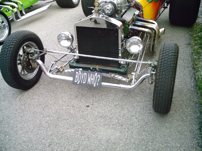

OK no problem. Was out yesterday in it. About 75 and sunny. Yea Haaa.

one more. Think this describes my feelings.

I dig it! Nice T!!!
