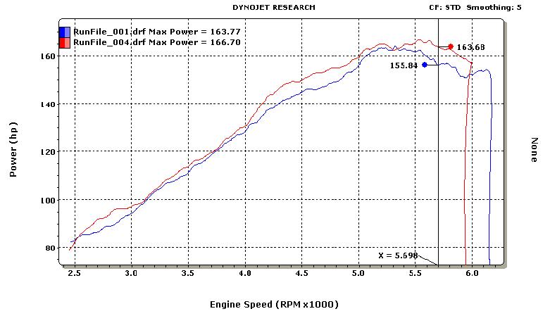

Looks like a 5-8whp gain from 4000-redline, not bad considering but different than the advertised numbers.

I totally disagree with your opinion.
A gain from a specific part is measured in all ways.
I do not (and I think nobody wants) to spend a significant ammount of money in order to get a part with a specific advertised performance, where these numbers will show up under specific constrains, specific variables, specific this and specific that.
The car is not be used in a specific world.
The car is used every day, and so the gains must be shown in all circumstances.
With you opinion, everybody is free to presume that alta basically "cooks" the results of the dyno runs to show whatever they want.
Things are simple, a member bought a CAI and a catback exhaust.
The gains were 6-8 hp. nothing more, nothing else.
And please, there is no point to insult other people's experience because they are competitors of Alta.
Because as I read you post, it seems that you work for Alta, so things are even.
In Greece, almost nobody uses ALTA, due to their high price and many doupts on their performance.
Miltek, Minispeed, Schnitzer, Lohen and local tuners with very obvious results in all dunos rule the market.
To find an untuned mini in Greece is probably, impossible
Especially for R56s, the use of a 3" exhaust is not so good.
The backpressure is reduced in a very significant way, and you only come up with less performance than was promising.
Scoobys have 3" exhausts, but do not forget that their engines are 2,0L.
A 3" exhaust should be a very nice mod only if you would plan SHORTLY to tune the car much higher, with a possibly larger turbine.

Greece is one of our LARGEST growing markets. Go speak to MiniSpeed.gr about the ALTA quality etc. They are a HUGE reseller of ALTA and the fact that you mention them in the same sentence as a slam that our products aren't well received is even MORE suspect as to your motivations and point of view. It simply isn't true and makes NO sense to this conversation. I have had no reports of any doubts in our technology, quality or performance from Greece.
The dyno results of 6-8 aren't disputed, they are simply being re-referenced to the type of dyno and setup being used to measure it. This is a common difference in dyno types. There is no criticism of the OP results (and I appreciate the business of course.)
Also, your comment about backpressure is straight up false. A turbo motor is nearly allergic to backpressure. And if you want a scientific and third party evaluation, I suggest you read Kenne Bell's books on the very subject.
Again, thank you for the post, my apologies if my reply is construed as harsh, but I respect your right to a differing opinion.
Let me know if I can help further!

As for the motivation, I just doubt the fact that with these 2 mods that our friend did, the gains were so low.
Miniclub.gr is the biggest club for Minis in Greece, 2695 members.
Alta just started to show up and gain some respect with PnP which is right now (this is my opinion too) probably the best product in terms of ECU tuning, along with Alta IC, not because of its price ($1260 in Minikinetics costs the FMIC, $1600 in minispeed.gr), but because of its perfect fitting and appearance.
Regarding the reports that you mentioned, the reason is that there are other tuners that rule the market..
As for the post counting, I subscribed here very lately, but in miniclub.gr my posts are reaching a four digit number...
Sorry but I read only the topics that interest me.
About dyno runs, here in Greece Maha Dynos almost rule the market, and are considered probably the most accurate.
But, one way or an other, the "greek" logic is that we dyno the car before the mod, and one or two days after the mod.
The results are straight forward in every case and in every dyno.
So, lets stay in topic.
We have an alta cai and a catback exhaust...
Assuming that the scoop is open(very important prerequisite as you very correct mention in you site) I think that the gains should be at least 12-13 hp at least.
Minispeed uses a TAT duno.
Mustang dyno is considered a very good dyno here and along with Maha, a very "strict" one...
Based on that, please do not consider my post offensive, but since the fact that Alta is starting right now to gain a market share in Greece (knowledge from 2695 minis in Greece), when reading that a car with a CAI and a catback gained only 6-8 hp, along with your very high prices (in Minispeed, because they just overcharge everything), makes me very sceptical about the acctual gains.
But, this did not stop me to install you PnP, your IC and the whole boost tube set.

There is one thing that i see that makes the graphs different than others. The launch RPM. Maybe the car was floored at 1500RPM and the dyno started its reading at 2500, then its ok. Also the engine seemed to be stopped earlier than normal. Its common for a dyno operator to stop the dyno after peak power. Cars make power at all RPM points, so had the dyno continued to 6500RPM it would have shown that same 6-ishWHP all the way. In the end, the power that we see vs. the dyno graph posted is very close. It shows the same power increases at the same RPM, just a little different numbers, which is expected.
I do not (and I think nobody wants) to spend a significant ammount of money in order to get a part with a specific advertised performance, where these numbers will show up under specific constrains, specific variables, specific this and specific that. The car is not be used in a specific world.
As we have said before, the dyno is a great way to show numbers. But in the real world there is only one difference that we can not mimic on teh dyno, more air flow. If we could mimic this higher air flow, we would see more power than on the dyno. So when we see a specific gain from the dyno, we can say for 100% that it will be better on the road.

Ummmm, no that is not true. The AFR is not closed loop under full throttle conditions above a certain point. This is proven by us modifying the MAF curve and getting AFR changes. And getting the AFR changes to stay. If you are using some of your Porsche tuning that is the case with those(at least from what i hear). These cars do have a wide band front 02 sensor, as does the mini. In fact many cars have widband front 02 sensors, but most do not do closed loop to redline. In fact besides the Porsche, i can't think of any turbo or SC car that does. But i can assure you that the Mini doesn't do closed loop all the way to redline.
Yes OP may not be happy with the results, but was the intake scoop pulled out?
The BMW N54 (335i, 535i, etc) use a fully closed loop system via. wideband sensors, as does the European R56. But my point wasn't to get in to a debate on how great MAF fuel metering is or isn't, we're talking about dynos here. And for my money dynojet tuning is more than adequate for a 175hp R56.
What's extra funny is reading people make the argument that dynojets read lower than full load dynos. Never heard that one before.

1) I totally agree with your opinion about IC. That's why I have already ordered one.
2) You mention: "But either way you are right it does show a gain in HP."
I know that I am correct, it is less than advertised.
3) You mention: "In the end, the power that we see vs. the dyno graph posted is very close. It shows the same power increases at the same RPM, just a little different numbers, which is expected."
It is 20% less, plus the fact (that it is nowhere mentioned here), that our friend has installed also an ALTA CAI. So, something is missing here.
Please, do not mention about air flow in road, because every dyno that respects its self, has a very large fan in front of the car in order to simulate this flow. ( At least in Greece...)
4) You mention: "but a 2.0L WRX in stage 2 or even 3 form makes about 210-230WHP. This is what we are seeing on the R56, in stage 3 form the 1.6L. Given the same engine HP, the engines are flowing the same amount of air, and in turn showing that a 3" exhaust can benefit from both."
The WRX is originally 225hp at the crank. Not stage 2 or 3. You cannot presume in any case that a 1,6L engine that has the same performance with a 2,0L engine, it produces also the same or more quantity of exhaust gases.
No, since the fact that they produce the same HP, the 2,0L engine produces more due to its size.
5) I know and agree that you do not in any way promote anybody to go with 100mph in public roads. That is the reason why we are discussing about dynos and etc...
