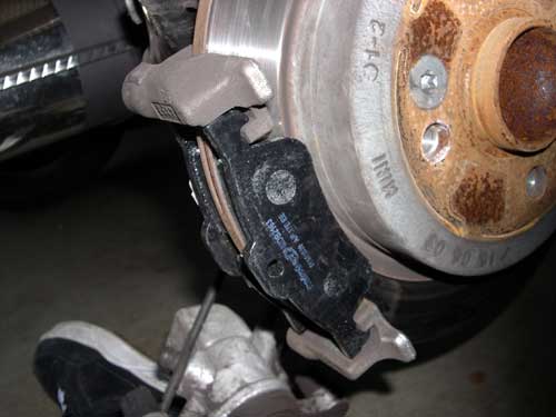

Rear pads don't fit
Update:
I received the DP31710C rear pads, but they don't fit the 2007 MCS. The tabs on the sides are too long. They look very similar to the attached pic (one of these borrowed from Octaneguy's writeup on changing rear pads). Just for clarification, the pics below are of the WRONG pads for the R56 MCS.
I hate to admit it, but I didn't snap a pic of the R56 pads when I had them out. I didn't want to get the camera dirty and didn't have any extra time.
On a somewhat related note, do the previous gen Mini's have aluminum rear calipers?
-JL

I've installed EBC Redstuff pads on my '08 MCS (non-JCW), these are the correct part numbers for direct replacement:
F: DP91789C
R: DP31931C
Don't have enough miles on them to render an opinion on performance.
