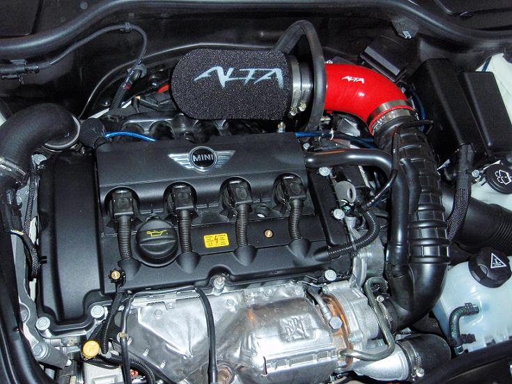

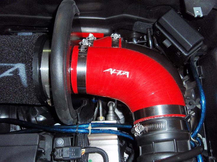

i just installed it today, however, mine is the EU MCS, the package is not as fit as it should be, the elbow doesn't really fit with the filter holder.....i have forced it to fit by loosing the 2 bolts on the holder, tight the hose and then tight the holder's screws again, it is a bit twisted now....
adam, isn't it like this for EU model...not so fit??

see the pics.....the filter is a bit tends to the firewall...not as hoz as other mini fans pics...
is the bov cover like how you installed?
it sounds great....when let gas off...phewwwwwww
the air sucking sound sounds like the mini is taking offffff......
btw, mine is MCSa 07

Hey thank you again for the business! To trim up the install a bit. Loosen the Inlet Tube at the Turbo, Then loosen the bolts securing the air box to the manifold. Then rotate the assembly to where you desire and tighten the air box first, then the turbo inlet hose. You can also loosen the clamps to the silicone elbow an inlet tube and make it so you can partially see the supplied aluminum extension tube as well.
Thanks again! Let me know how I can help further!
