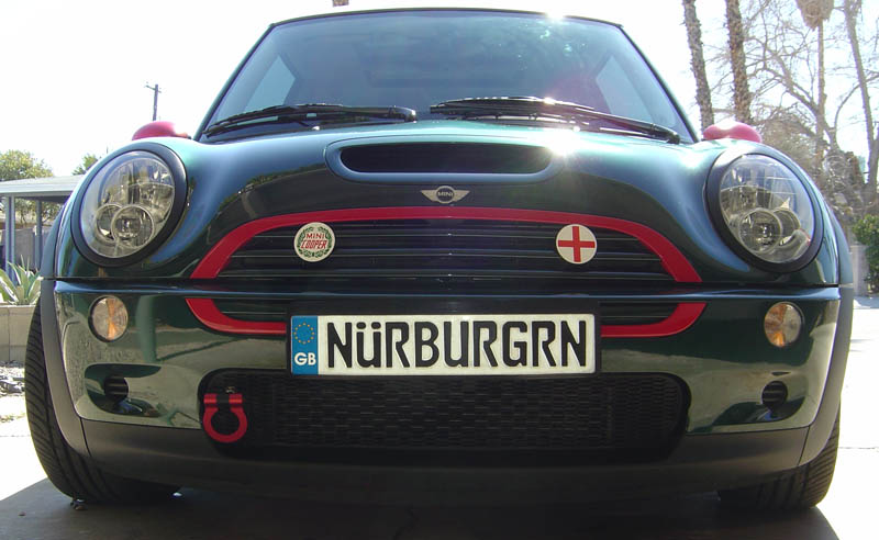

Originally Posted by tazio
You can't touch my mad Vinyl Style
Oh,I can tosh it mane!
