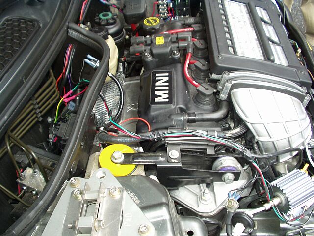

Do any of the aftermarket bushings have metal washers to distribute the mount loads to the bushings? I don't like the looks of the mount digging into the yellow bushing:

Davbret digs into his brain to remember the install from a couple weeks ago....
Hmmm, I know the front passenger side engine mount (purple in the above picture) does have a metal inner sleeve, but I don't believe there are any "washers". How would that help transfer anything? Using your example of the big yellow passenger side top rear mount, if you had a washer, that would only affect forces pushing down on the bushing, not lateral movement.
Do you mean inner metal sleeves to keep them from ripping apart so to speak? I've got a full set sitting on the work bench right now. I'll pull them out and snoop this out later today when I get home.

the bushings need, and do not come with, large washers to distribute the load over the plastic; when I get a minute, i'll whip some up for my rig. You can add the poly mounts in about 15 minutes... support the engine, remove the two bolts and a few wires that may be in the way, pop in the poly parts and put it back together. the hardest part was getting the rubber w/steel sleeve bushing out of the bracket at the motor end. Use wd-40 and hammer it out with a dowel.
