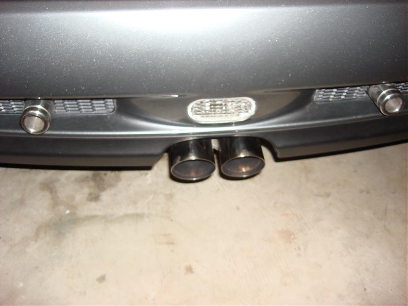

Executive Summary: Just installed a Milltek exhaust and love it. The sound is awesome and the power is great.

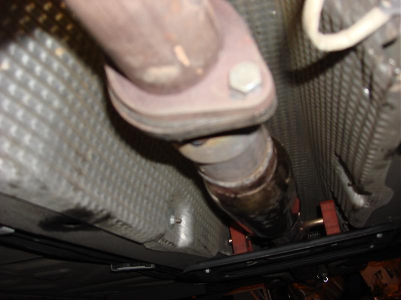

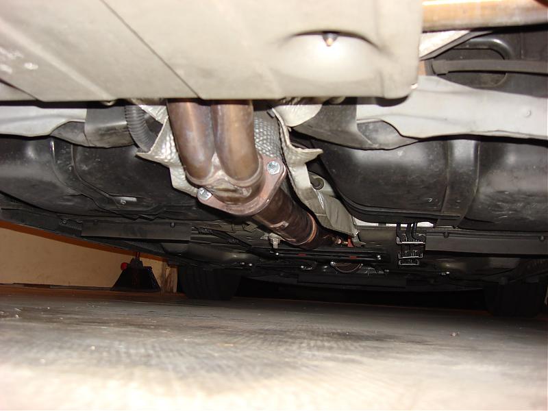

I moved to the center of the car, centered the exhaust pipe, bolted on the center support bracket, and ran into a problem.
The flange on the resonator didn't perfectly line up with the flange on the Cat. The length was perfect and the pipes were flush with each other, the problem was that the flanges were rotated a few degrees away from each other. Meaning that I wasn't going to be able to get 2 bolts into it. So I put a bolt into the bottom, cleaned up, and started it up.
MAN WAS IT LOUD!!!!
So today when I drove to work it was very loud. At lunch I drove it down to a muffler shop. He cut the flange off of the resonator and bolted it to the Cat. He then welded the resonator back onto the flange. That was much easier than I thought. He did it in 30 minutes, for only $35, and he threw in a flange gasket and a couple of bolts for that flange.

The moment I turned it on, it sounded beautiful. I had a smile ear to ear. I drove spiritedly back to work. The power increase was definitely noticeable, to say the least.
