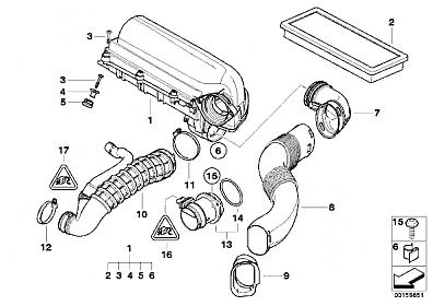

I can ensure you that the european mini doesnt have a maf(because mine doesnt have) and you can see that here!
Old May 18, 2007 | 03:43 AM
  #35
Hattat's Avatar
Hattat
Joined: Apr 2007
Posts: 79
Intake systems are different. But I'm not sure EU spec cars don't have MAF sensor. It may be located somewhere else. But from the pics below you can see there is no MAF sensor on EU spec cars. Also filter elements don't have the same part number.
WELL THAT SUCKS! Looks like we will have to make something special for the Euros! That also means that most of the ECU flashes being made over there, will not work on the US cars!
