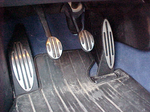

I must have fat feet, I have no problem - like some of the others, I use the ball of my foot on the brake pedal, and the right edge on the gas - works a treat..............here are my pedals........
