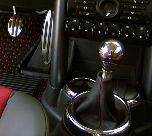

I have an 06 MCS with octagon tartan red cloth/leather, and a set of red/black coco mats on the floor (see attached thumb). I have treated both cloth and mats twice with 303 and so far am very pleased.
Application: I removed the mats from the car, sprayed until soaked, let dry 24 hours, then repeated.
I had good results on the seats using a fine textured ROUND foam sponge applicator (such as used to come with Turtle Wax, I think, but don't quote me. I don't remember where I got the red ones I have). Instead of spraying the seats I SOAKED the foam applicator with 303, then applied to the cloth, resoaking the foam with 303 as needed throughout the process. Take your time and be patient. I found it was fairly easy to control the application of 303 just to the cloth, not the leather, by using the foam like a paint brush, rotating through the leather/fabric curves. Really soak it in. The cloth gets all wet and dark, but don't worry. It drys completely within a few hours. I then repeated. The cloth may seem very slightly stiff afterwards.
I only drink water and never eat in my car, so don't know how easily something like mustard or hot chocolate would clean up. Water beads up nicely. If I get a dirt or dust smear, I use a micro fiber cloth lightly dampened with water or EinZett Cockpit Premium and the stain wipes right off. The seats and mats retain a full rich red color. I plan on renewing the application once a year or so.
