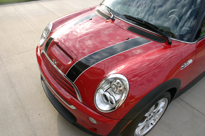

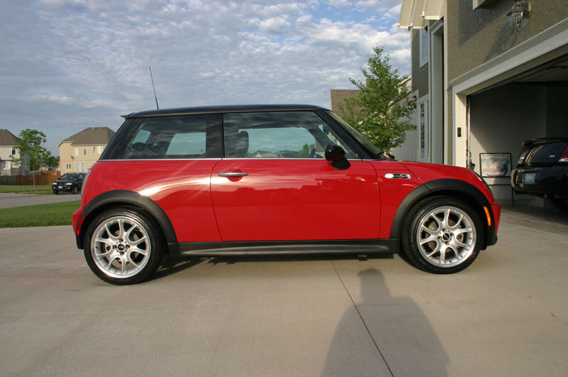

2nd attempt with new 7424
Okay, so this past weekend, I had the first chance to use my new PC on my MCS. While it took less time than my wife's SS, it still took me about 4 hours or so, and that is with 3 products being applied and removed.
For my MCS, I went away from the consumer line of Meguiar's Deep Crystal 3-Step process, and instead used their professional line, with the exception of the final wax - the shop I purchased the products at did not have the #26 wax, so I used NXT instead.
Step 1 was #82, step 2 was #7, step 3 was NXT. Some pics attached below.
These were applied with LC VC pads (White, Grey, Blue - in that order), and the NXT was removed with a microfiber bonnet.
Attached Thumbnails 1st attempt with new 7424-mcs3.jpg   1st attempt with new 7424-mcs1.jpg   1st attempt with new 7424-mcs0.jpg

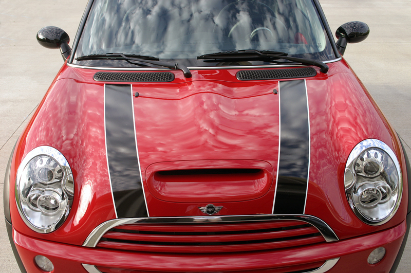

Oh, and here is an up close shot of the fender.

Great work! If you can get away with M82 to begin with, then swirls aren't much of a problem! By the pictures, it looks great. Both #7 and NXT have some swirl filling properties--#7 is just a pure polish without any abrasives. Not saying you didn't work them out, just making an observation. Regardless, that deserves a
Richard
Richard
I was considering #80, which is what the guy at Meguiar's recommended, but I made an executive decision that I didn't need that much abrasiveness and went with #82 instead - I think it worked well.
I haven't really had any of what I would call 'true swirls' in it at all - but enough of an imperfection (to me anyway , to most people not really) that I wanted to use just enough of something to remove anything that might be there. But, I'll use it sparingly in the future.
Like I said before, I was going to go with the #26 over the #7, but since they didn't have it, I used my NXT. From what I understand, NXT will last longer than #26 and it has the most 'shine' properties of any Meguiar's wax (again per a guy at Meguiar's).
So, I think I've found my product trio to use, unless you have any other suggestions to add?
I was really shocked at how much more gloss/shine there was using the #7 followed by NXT - I mean it REALLY made a difference, hopefully that can be seen in the pics.
Thanks! BTW, I surfed around your site the other day...lots of good info there, I just may have to join!
