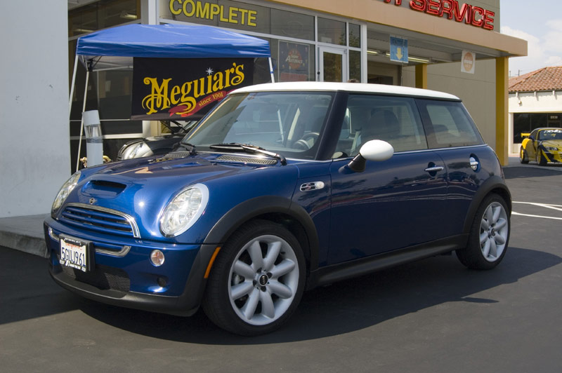

I detailed this 2004 MCS on Saturday at a clinic we did for Autobacs and Meguiar's. It had never been detailed in it's 24,000 miles and we claybarred and NXT. I did use M83 (DACP) for the bonnet to remove the major cobwebs and swirls it had. The deep shine is from only 1 coat of NXT. The owner said he had never seen it look so good even when it was new.
Richard
Richard
