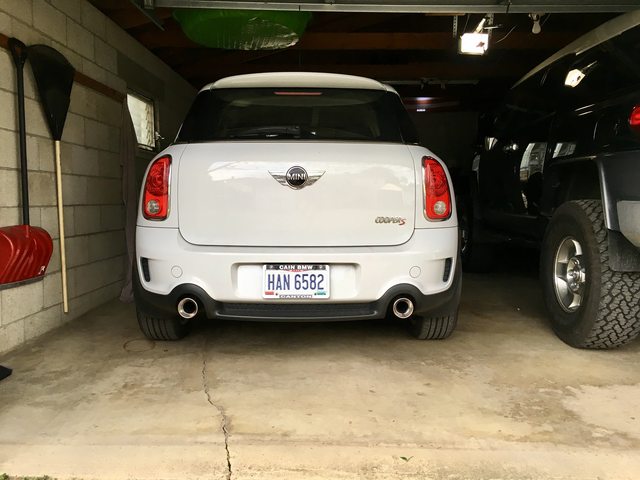

The ones on our R60 were beyond help. Very crusty to the point that the metal was a little eaten up and corroded.
I just covered them up with new tips! Plus you get the chance to upsize....bigger is better!
Yes the stock tips are under those

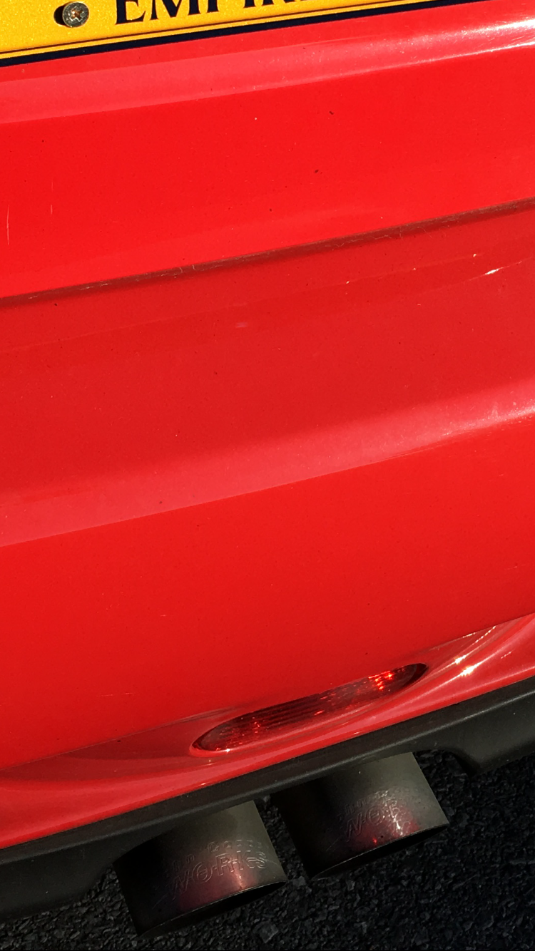

The trick all the detailers use is 0000 steel wool. It is so fine it will not scratch the tips and does a great job of getting all the gunk off. I've used it for years - makes a painful job so easy.
Attached Thumbnails Cleaning crusty exhaust tips?-img_4348.png   Cleaning crusty exhaust tips?-img_4331.jpg

This is the stuff I use. Just rip one pad in half and use a bit of polish or whatever you have lying around for tip cleaning - or even some wax would work. Works amazing. No more elbow grease. Cheap too - $3.70.
Amazon Amazon
Holy cow that pic is huge, lol sorry.
