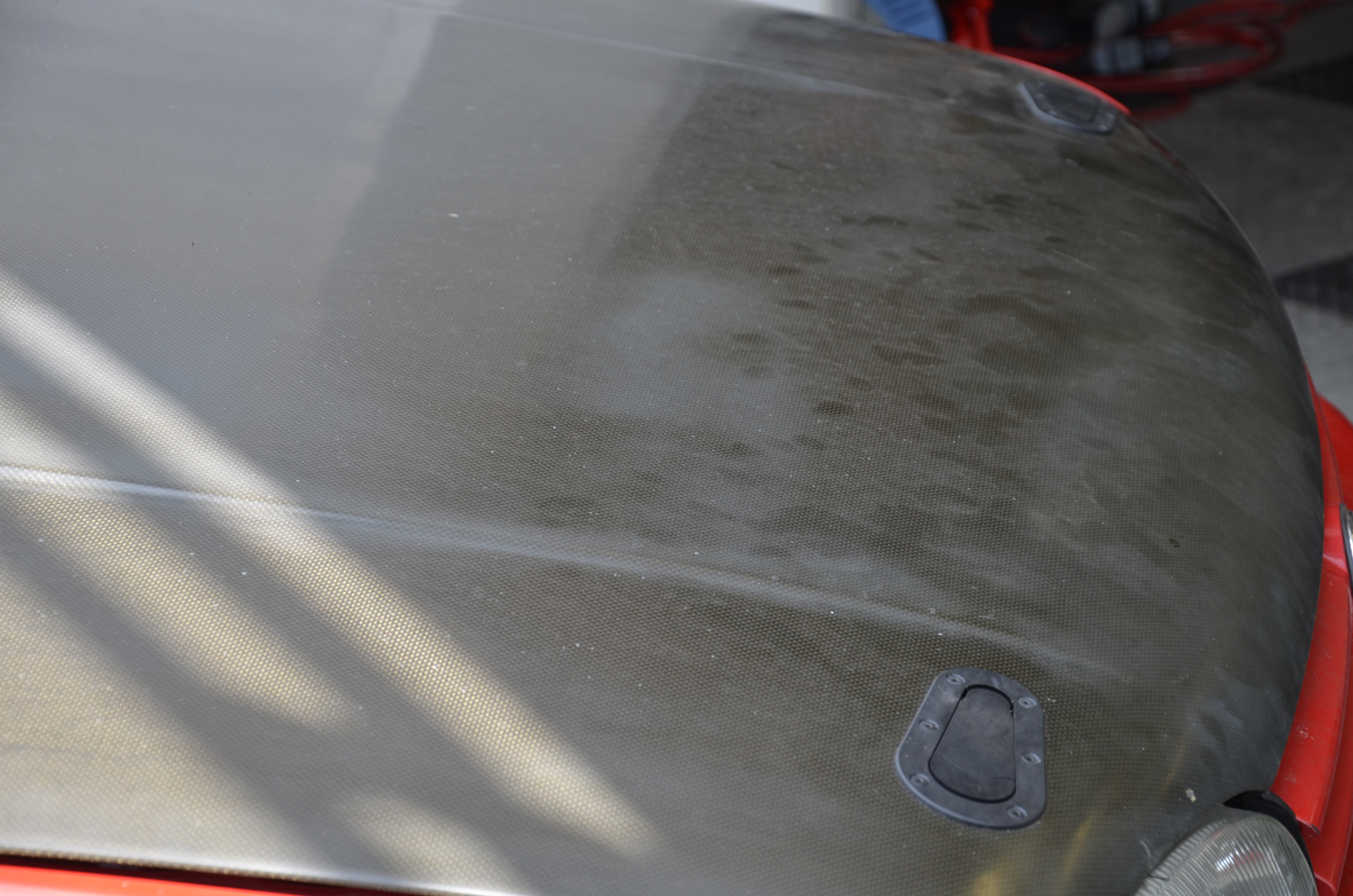

Here we have an oxidized carbon fiber hood which has clearly been neglected - owner stated over 4 years of neglect.
Using the Rupes BigFoot at speed 6 with the Meg's MF Cutting Pad with Adam's Paint Correcting Polish finished down with Adam's Orange Foam Pad and Adam's Paint Correcting Polish - we were able to clean it all up.
Before

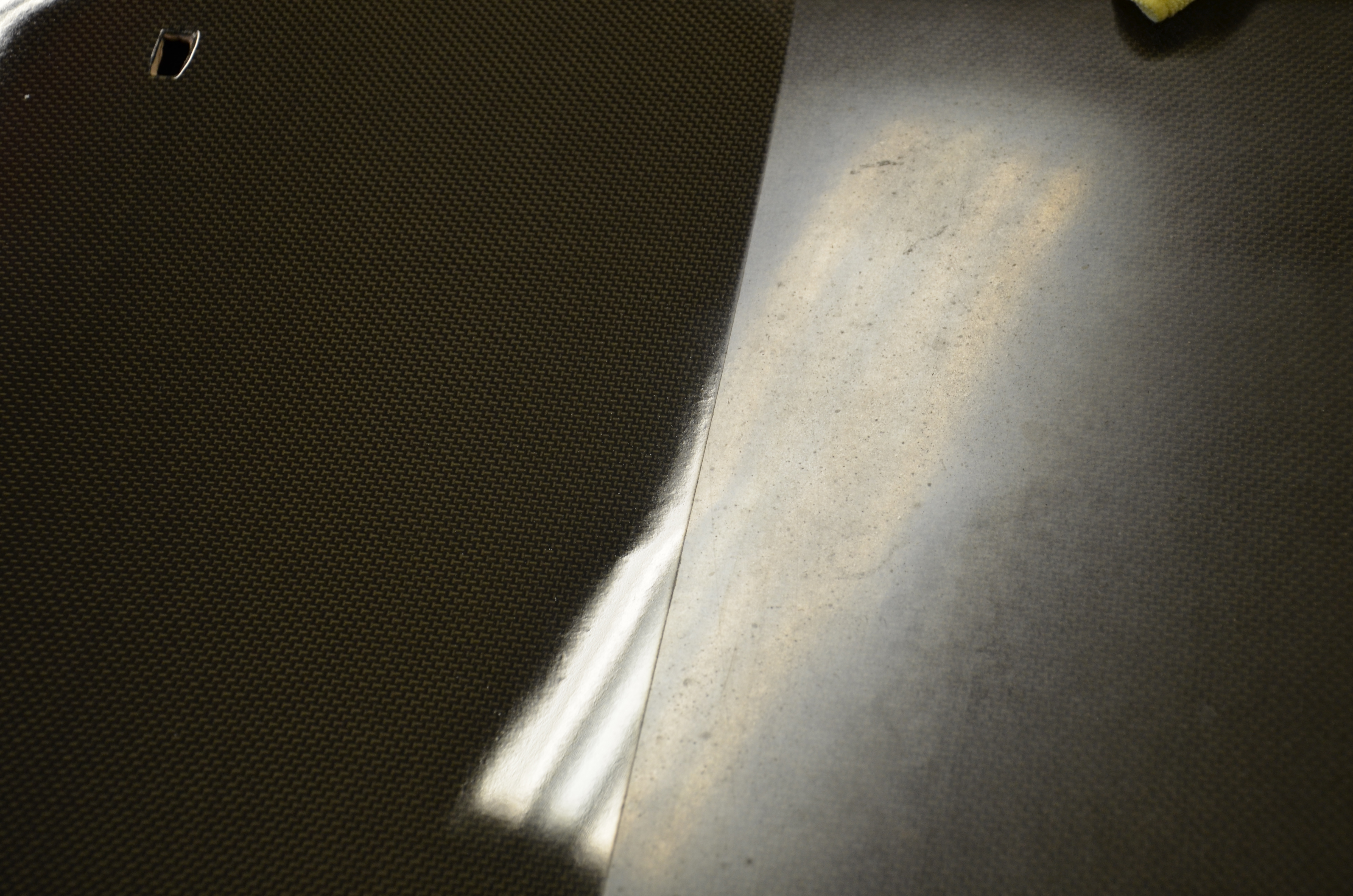

50/50

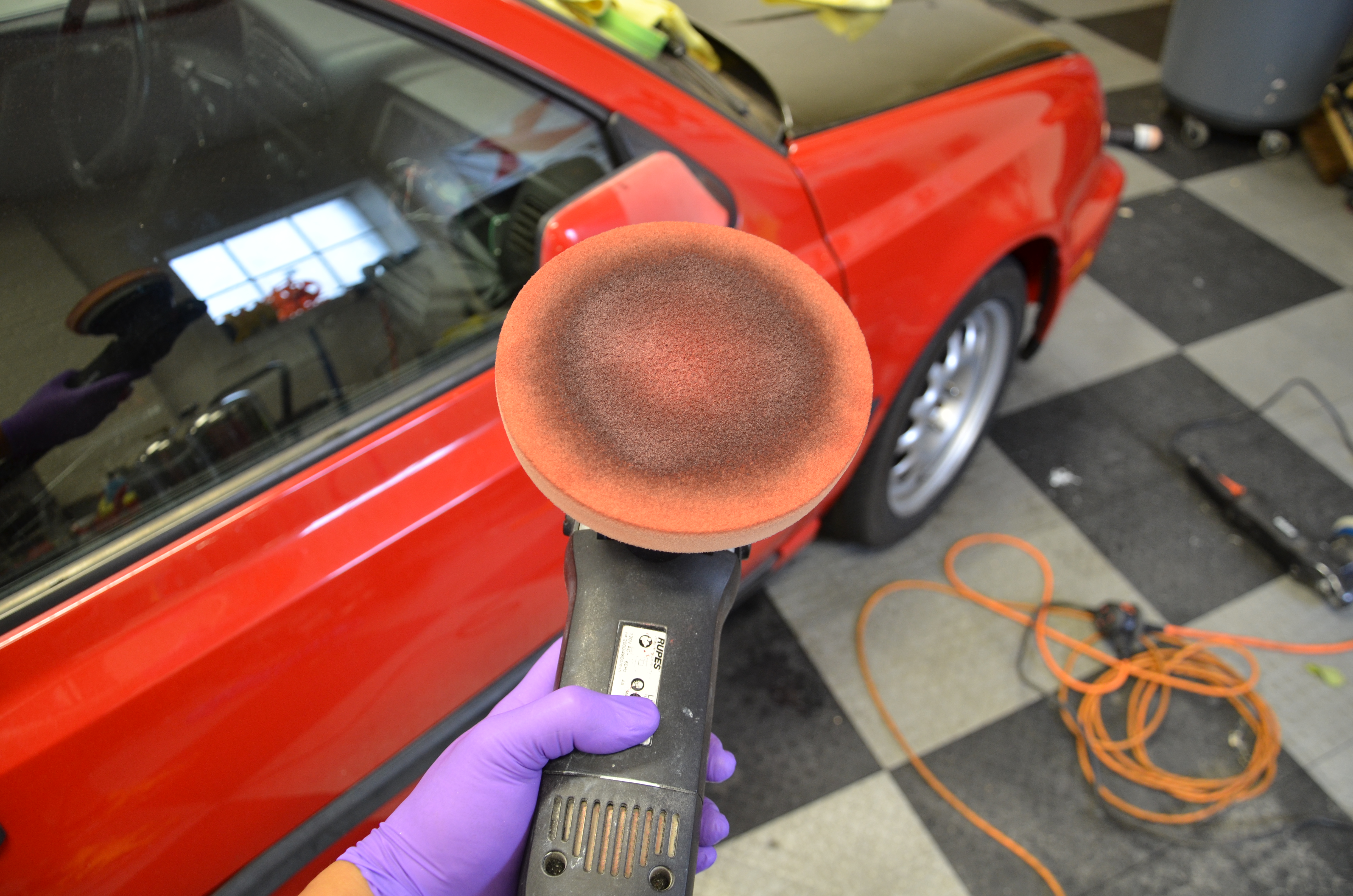

Here we remove all the oxidation off a VW MKIII with the Rupes Big Foot and an Uber Orange Pad with Adam's Paint Correcting Polish.
Before

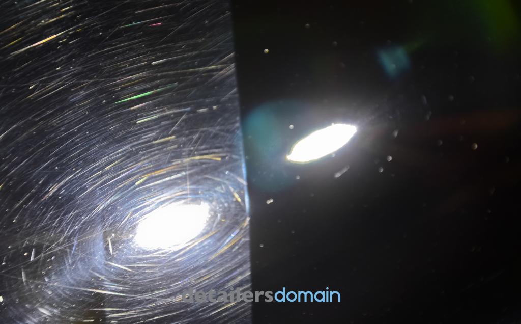

Using the Rupes Big Foot and a Microfiber Cutting Pad with Adam's Paint Correcting Polish on a 2001 Audi S4 Avant Wagon in brilliant black
