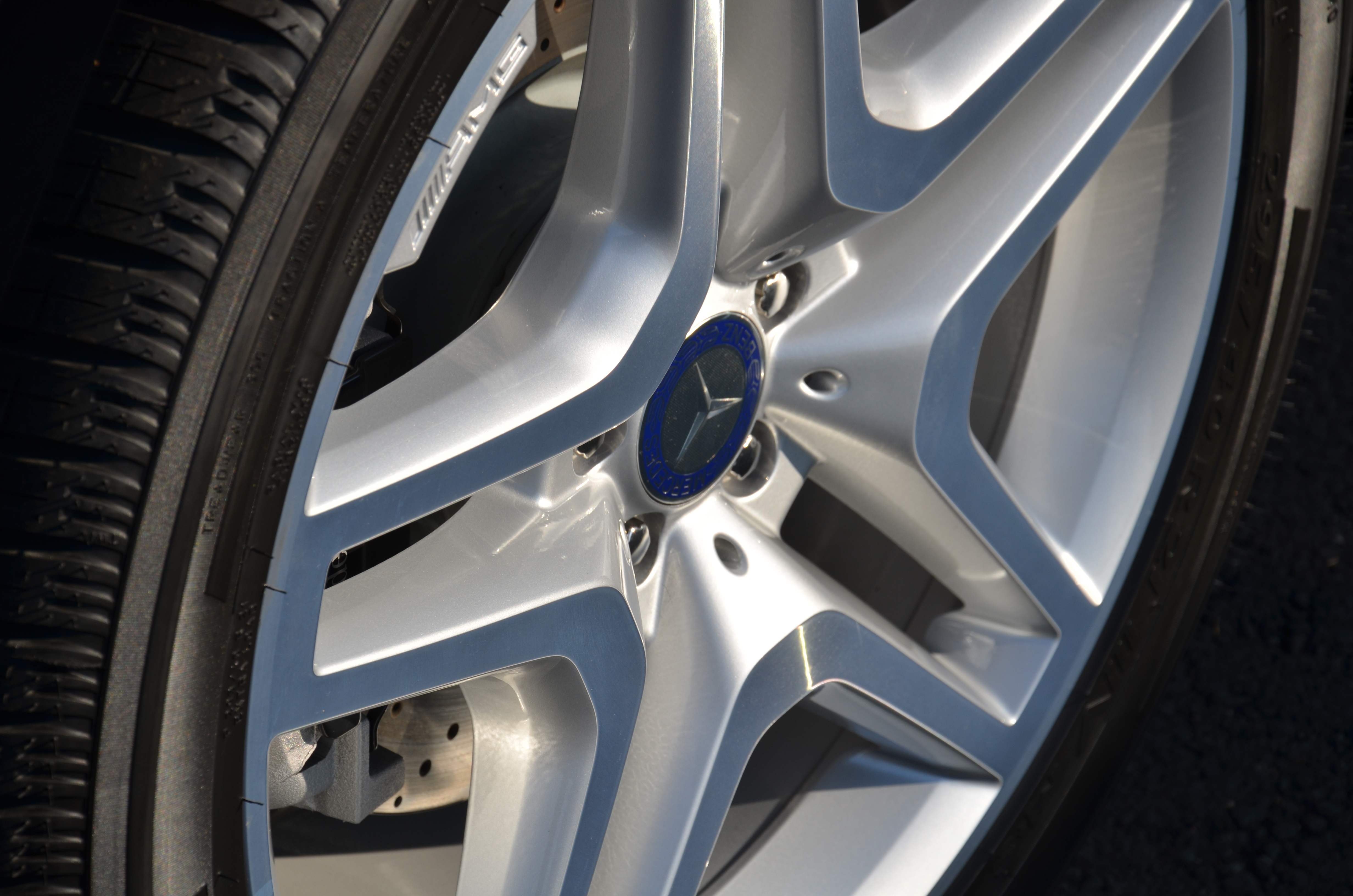

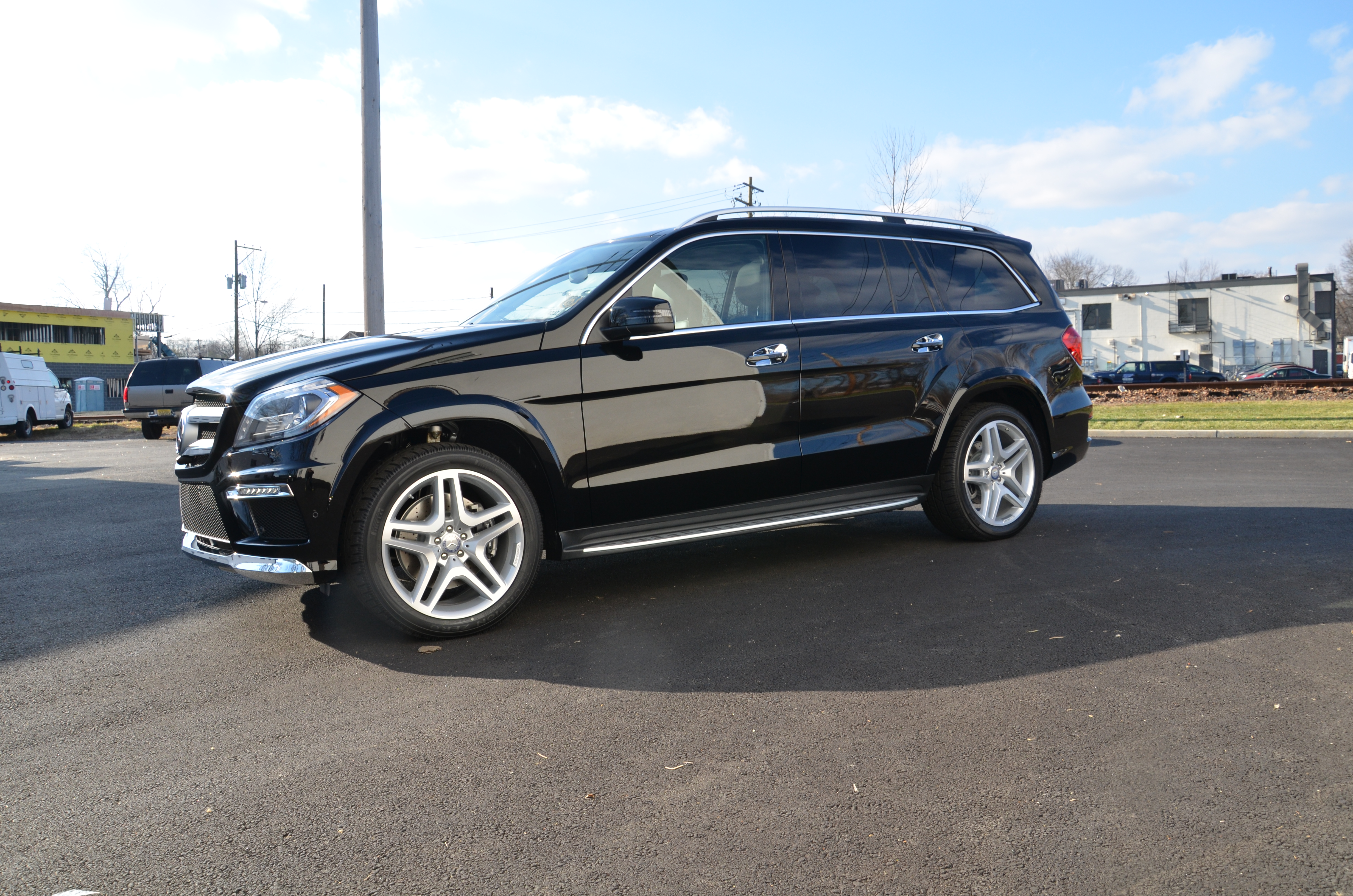

Before - when this car arrived it appeared that it needed nothing from afar.
Closer look
Sorry no prep shots (under some time constraints on this one)

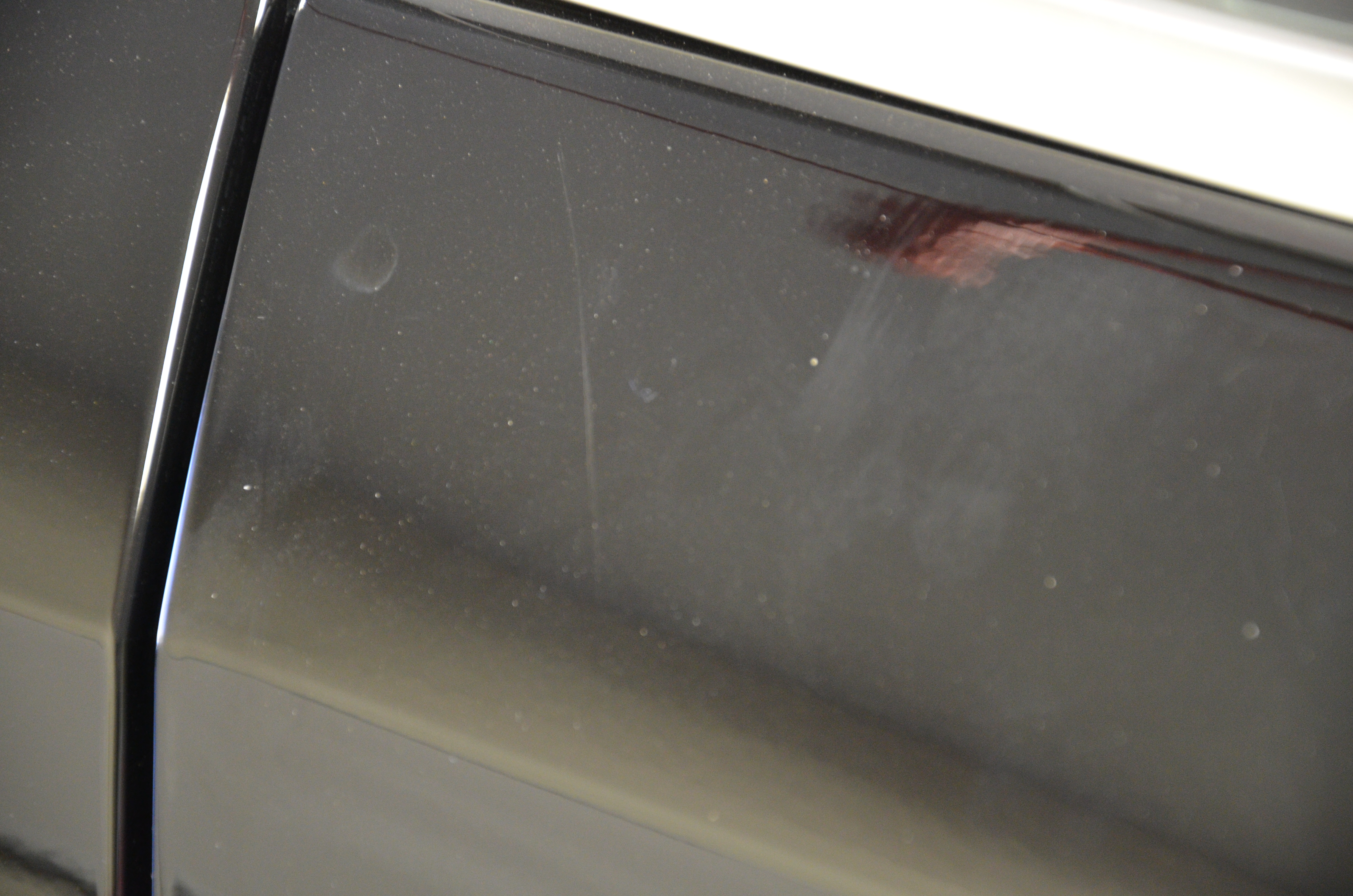

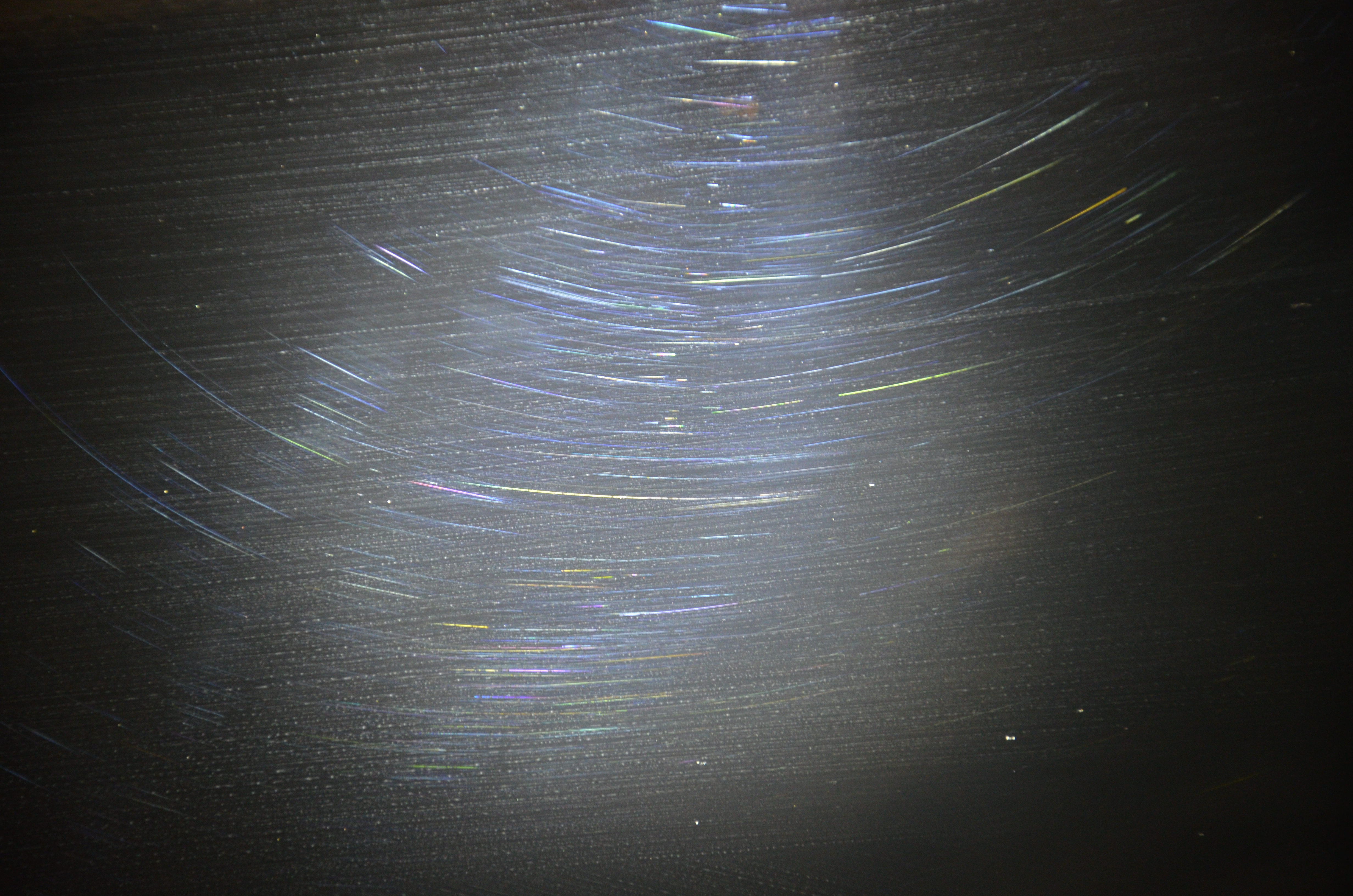

After the prep we found
So we brought out the Rupes BigFoot LHR 21ES and went to work

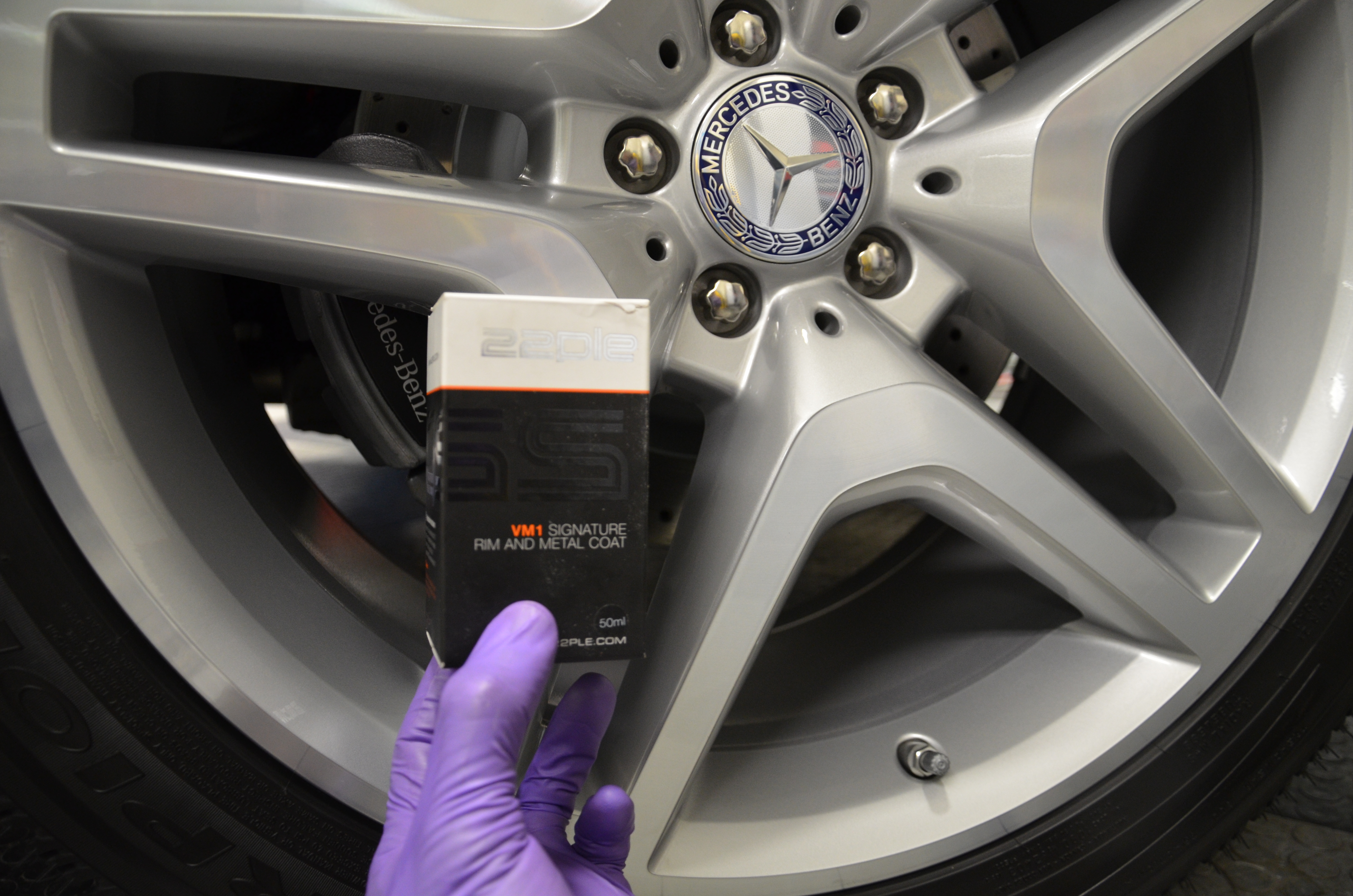

22PLE VM1 Wheel and Metal applied on wheels

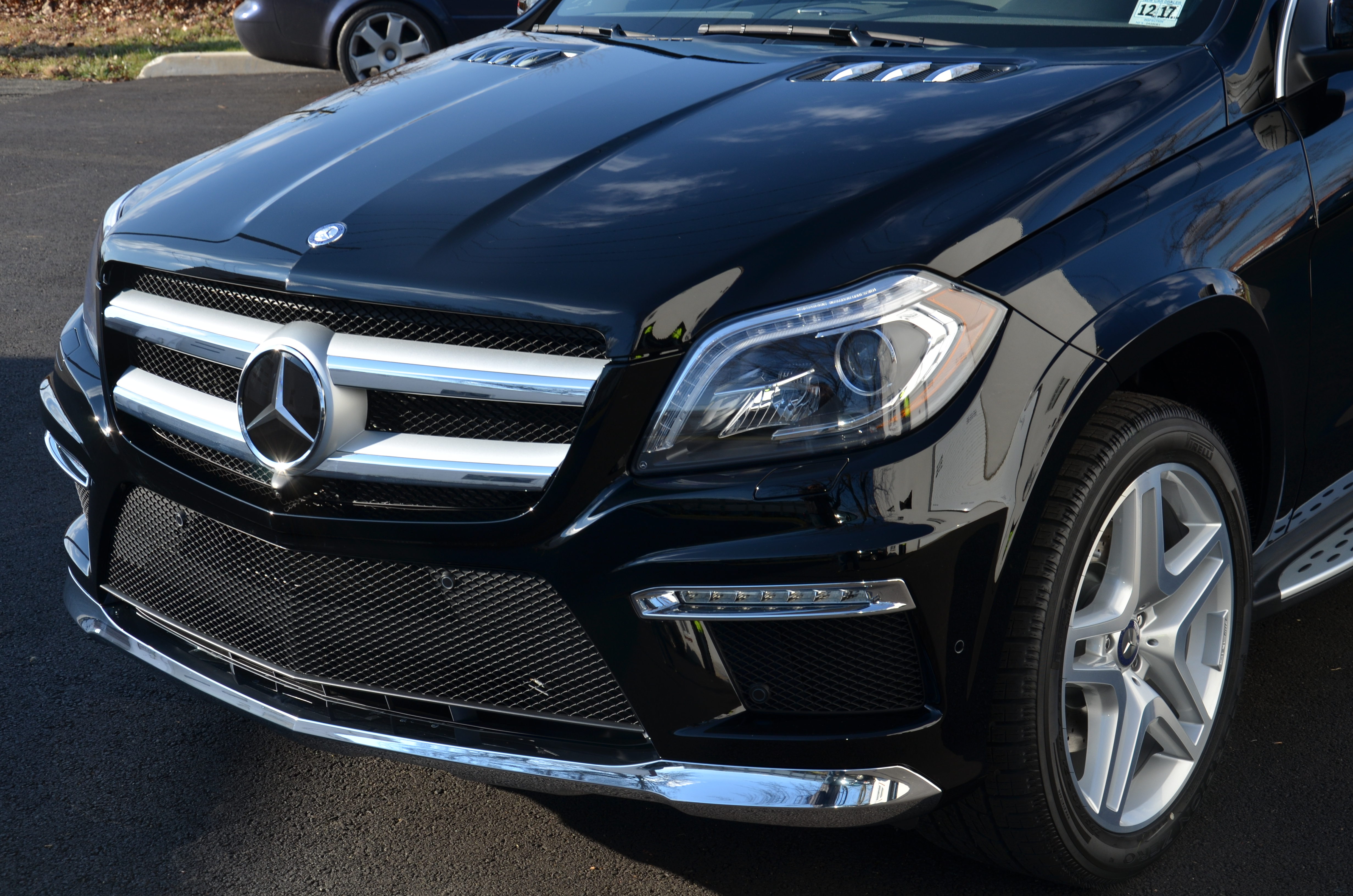

22PLE VX1 Pro Glass Coat applied

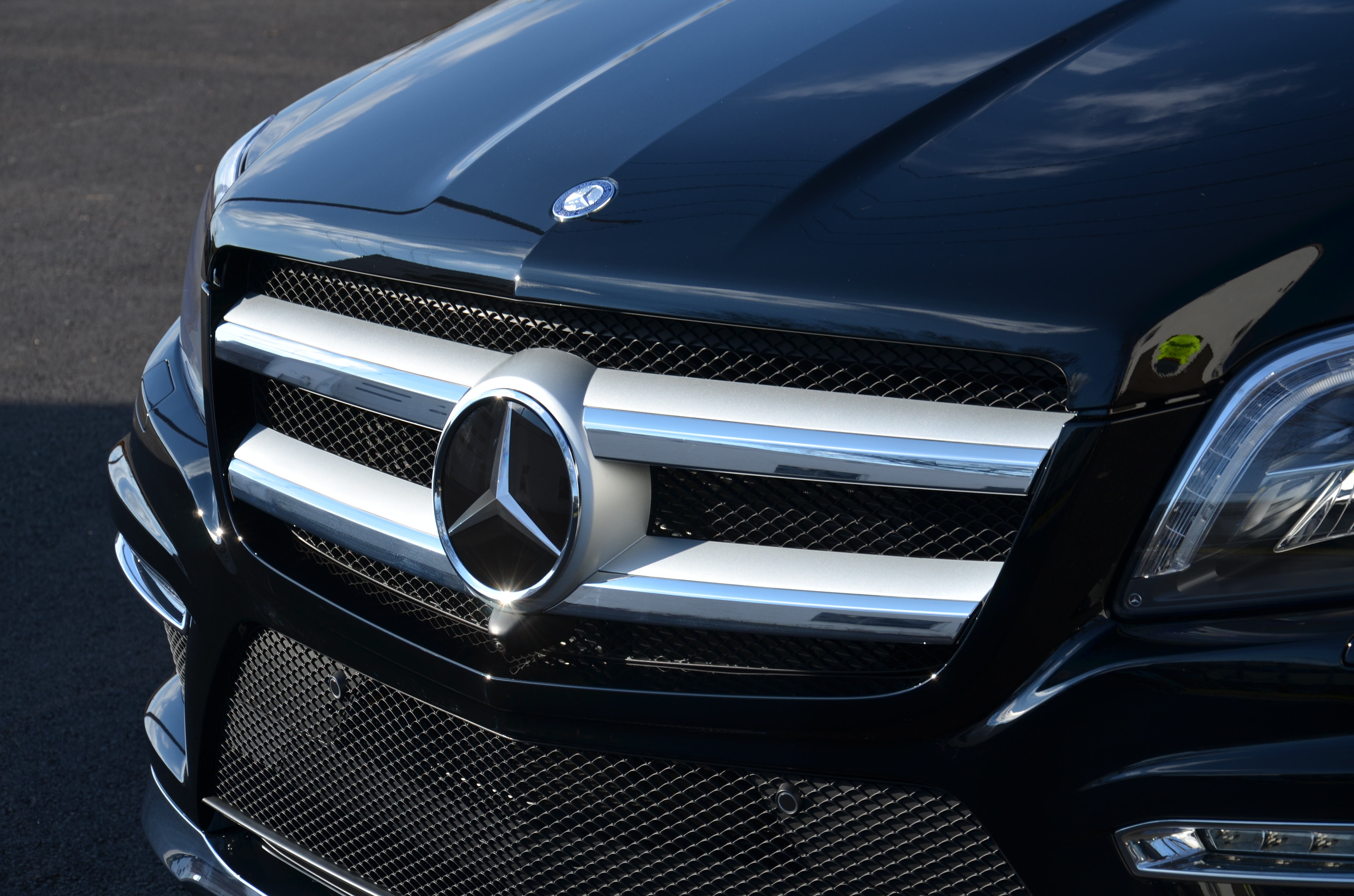

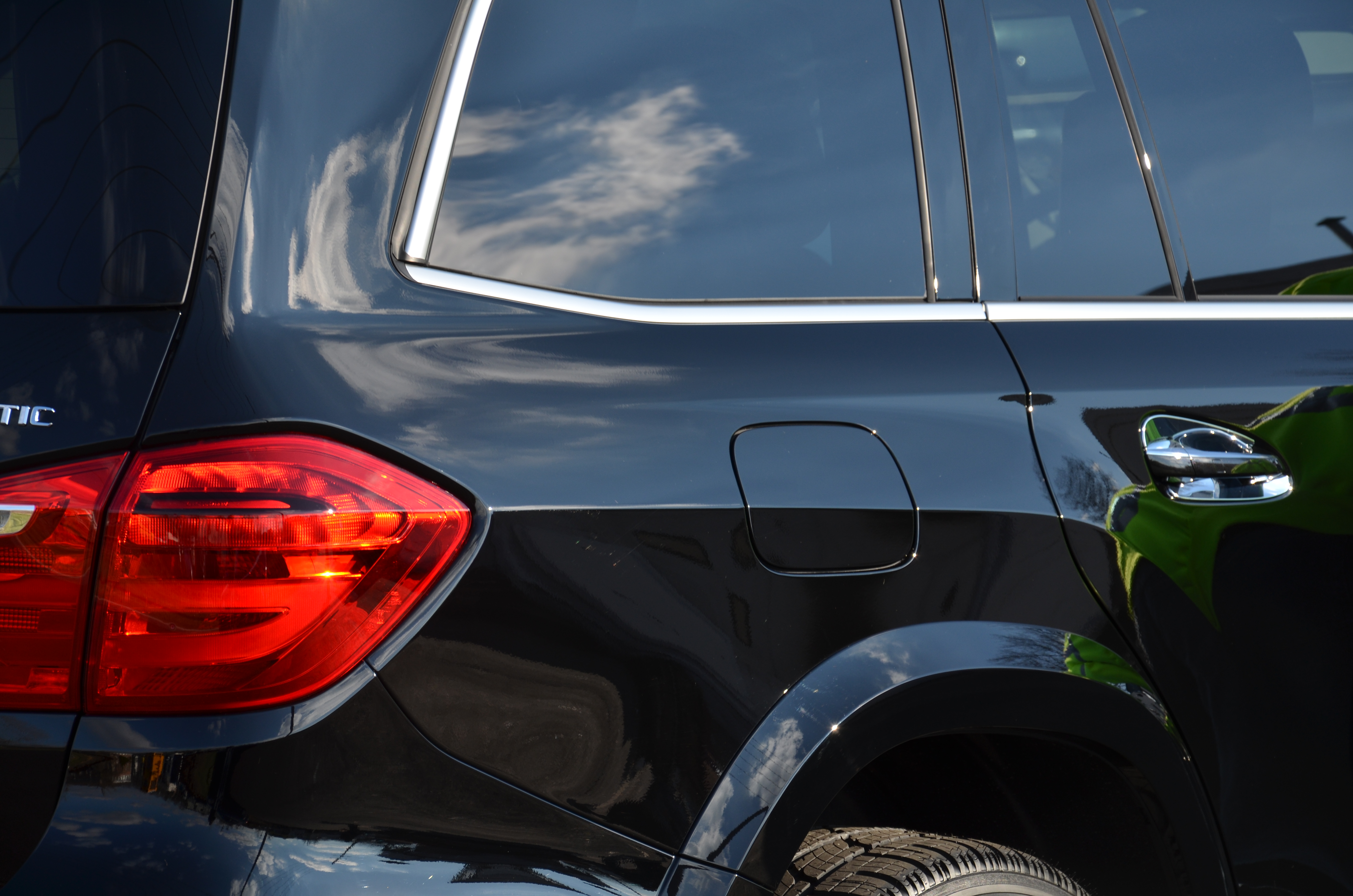

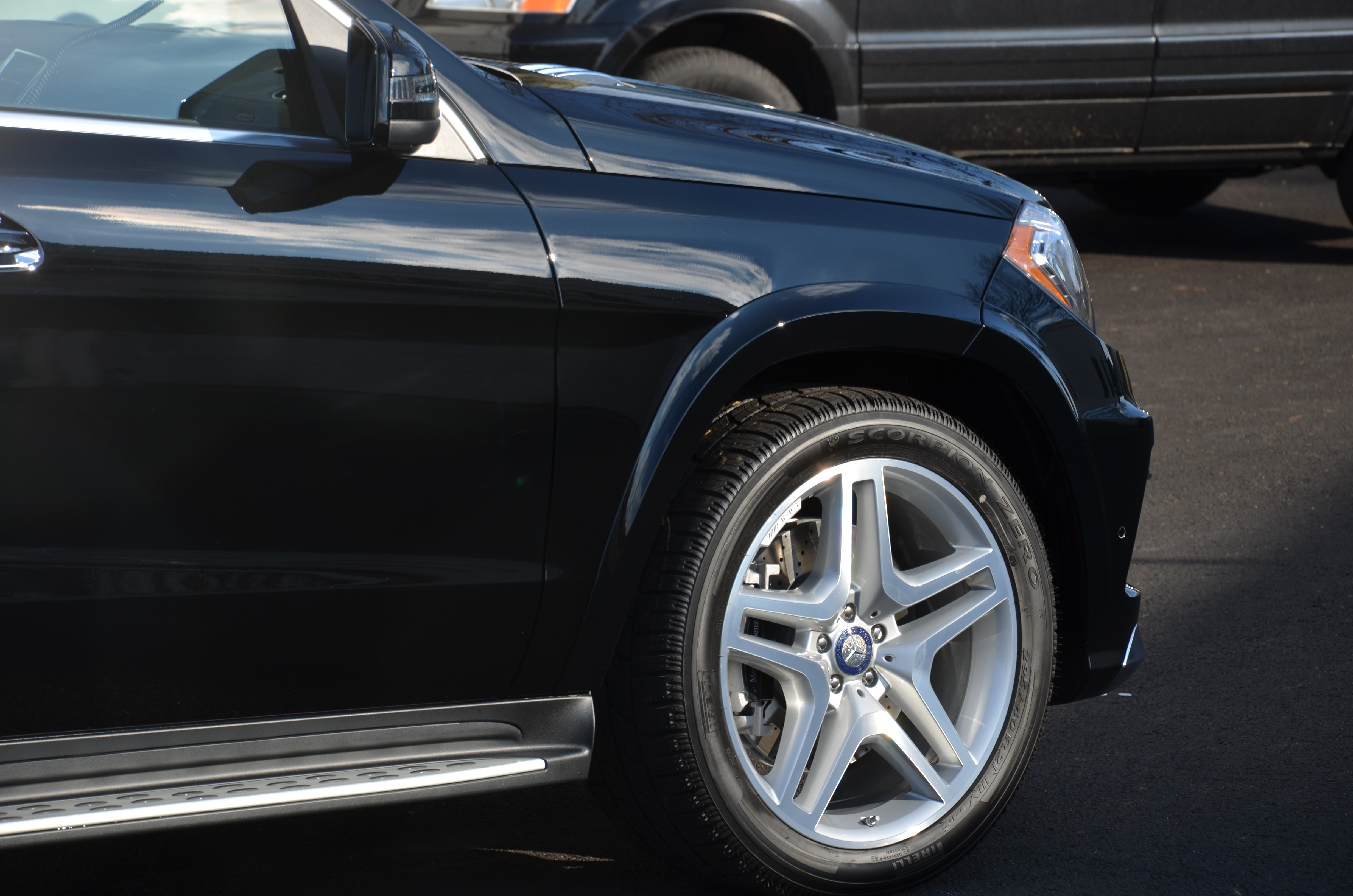

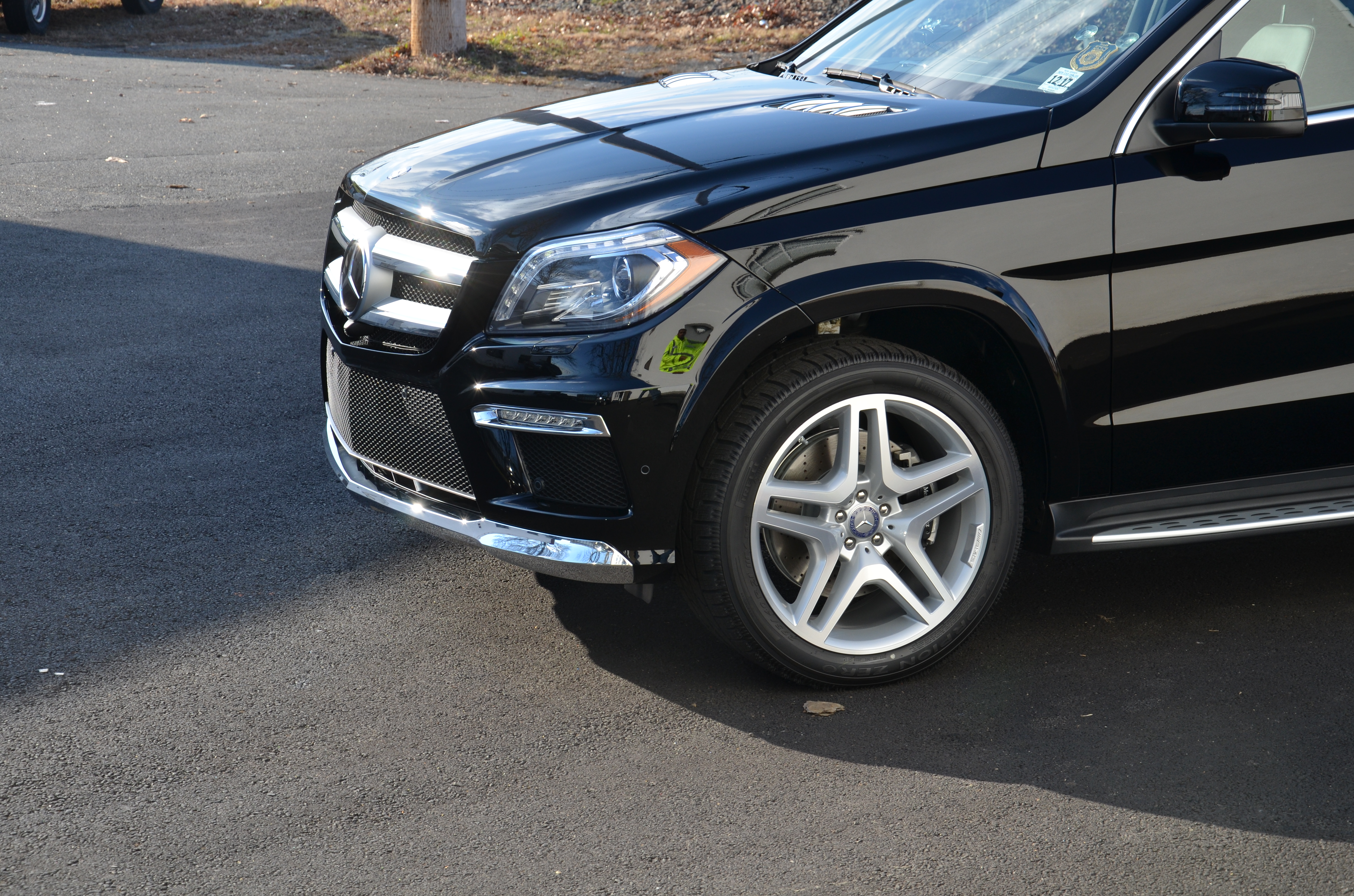

Some after shots
Enjoy!
