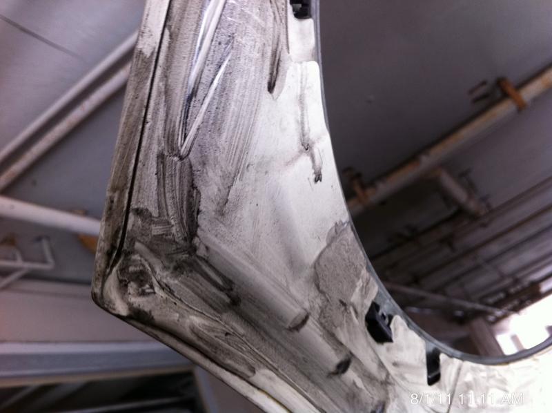

I just notice my 07 mcs is so dirty under the hood. I already bought the Prima Cosmonot from Richard the Octaneguy but doesn't seem to be the right product for all the black greasy dirt. Anyone has tips for that problem? Much appreciated.

I use a steam cleaner
cuts the goop quickly while not introducing so much water to cause problems
if the crud is really tuff, I'l hit it with diluted POR Marine Clean and a bristle brush to loosen things and then follow with steam
http://www.por15.com/MARINE-CLEAN/productinfo/MCG/
I clean the engine of my 79 this way annually.

You can try some diluted simple green that works for me. There is no clear coat under the hood so it's easy to take paint off if you aren't careful.

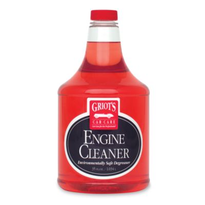

Even diluted SG took paint off under the hood in the non-protected areas!!
I use this...

I agree with the posts that say either a steam cleaner (works really well) or a mild cleaner.
The one bit of advice I would give is get a pump tank garden sprayer to wash whatever you use to clean under the hood. The pump tank (weed sprayer) puts out enough pressure to wash away gunk and soap without getting water everywhere and is very easy to direct.

There is a way to prevent this. Just take a very slightly damp microfiber cloth and clean under your hood each and ever time you wash the car. To me it is just the normal routine when washing the car. I use a cloth to wipe off the door sills and all the nooks and crannies throughout the whole car. Including the boot area. Under the hood is just part of this normal routine. We have had our cars over two years now and the engine bay looks almost as good as the day the cars were new. It just takes a little time and work. I have a pressure washer at home as well and every 6 months or so I give it a quick spray to get rid of the dust and such in the places where the rag cannot get to. It's really not a time consuming process at all. I use Griots products as well and think they work well. So giving that a try would be worth it. (We have a Griots store nearby, I can spend hours in that place. They have a lot of cool stuff for car maintenance, plus a lot of old race cars in a museum in the building.)

I have always used motorcycle cleaner, either S-100, or Honda-Brite. I spray it on, let it sit for a couple of minutes, gently wash it off with a hose and water, wipe as much as possible, then take the car for a drive for the final air dry. Both of these products are ph neutral and won't harm paint. They won't clean serious caked on grease, but your car shouldn't be that dirty anyway.
