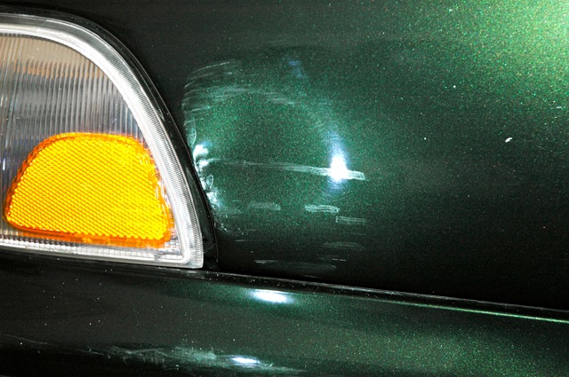

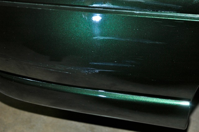

This is what I used to fix a Volvo where the previous owner had smeared on touchup all over. Langka removed the old touchup easily despite it being on for over a year, and I determined that 80% of the damage was just transfer that removed easily. The rest was wetsanded and compounded.
I'm not a huge fan of Langka for blob removal, but I do use it for this situation, to remove old paint easily.
Here's what the paint looked like that I removed..pretty horrible. Unfortunately I didn't take any afters.
