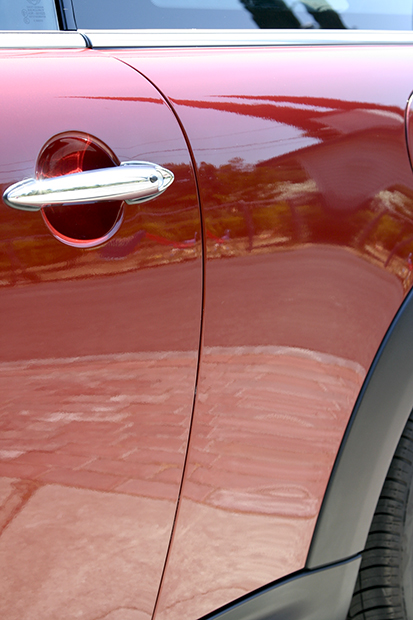

Today was my first Prima detail on my 08 Nightfire Red MC. I had two coats of Meguiars #26 on the car so I started with a dish soap wash to remove some of the wax. From the wash I clayed the entire car including the windshield (thanks for the suggestion Heather) and was quite happy that the paint was looking excellent; no swirls, spiderwebs, just a few scratches from the dealer or myself from the first wash a few weeks ago.
On to the Prima goods. The paint looked good and that was in my mind when I ordered the Prima Finish. Instead of Swirl. Should have listened to Richard. The few scratches I have must be deep enough that Finish with the white pad will not remove them or (most likely) it's my technique. I'm leaning towards the technique. Although I was working with the PC on 4.5 and was using a very slow arm speed the scratches did not budge. I was seeing something I thought was odd; lots of small specks of Finish splattering around within one minute of starting a 2X2 area in few spots. I thought I had the right amount of product on the pad and was using the correct technique (thanks for the DVD Richard). This is what I was getting:
I decided to continue with Finish thinking even if I was not exactly getting the Finish to work as intended at least I was probably doing some good.
Next was Amigo. On and of very easily but another technique issue; those scratches were still visible. Maybe I'm asking to much but I do not think so. The scratches are not visible unless you really look for them with the correct light at the correct angle. Outside of the scratches as I Amigo'e away the paint was clearly turning into a wet, glossy finish. Very cool.
Finally Epic. No questions there. On and off very easily with about 60 minutes of drying time. Paint darker, more "wet" gloss, outstanding stuff. A bit of Black Wow here and there and I'm done.
All in all a successful first attempt. Some lessons learned. This stuff takes time to learn. I'm positive many folks here could have pulled those scratches right out with Finish or filed them with Amigo. I'm keeping my eyes out for the Prima edition of the DVD. One other lesson; a set of 4 inch pads would have made many spots on the car (especially where the front quarter panels drop down to the hood) much easier to work on.

We went on a club ride this weekend and I got my first chance to see your color - awesome! I really like Nightfire. Our club member had it on her cabrio and it was stunning.
So anyway, Finish is very fine and I hardly ever find a use for it. The black A-pillars are the only parts I use it for. As for splatters, these should be minimized if you don't lift the pad. Start the machine with the pad down and only lift it off the paint after you turn it off. You may have done this, but I really don't get much fling while polishing (Cut is the exception).
Amigo will fill the fine swirls, but it won't perform miracles. It will help to minimize the larger scratches but nothing beats getting them out if at all possible.
Oh and I agree that the 4" pads, while not a must, do make my life much easier for the pillars, boot and swoopy areas around the headlights.
