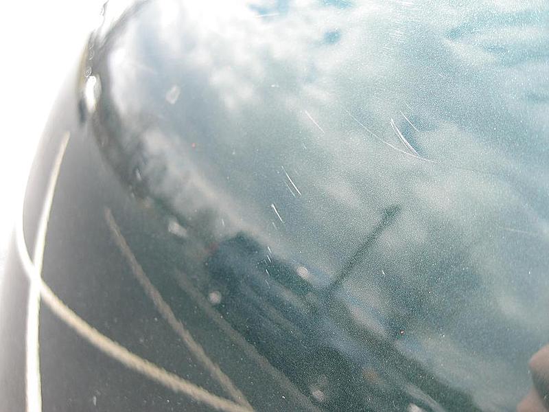

i've been looking into the whole detailing thing. i've ordered a PC and bundle from DP and i want to make sure i clay before i polish and wax. so i've been looking and Meg's and others have more than one type. there is fine and mild and medium and others... what should i use?
so whats my car like?
i've had it for 1 year and have not applied wax, we just bought a house and i work full time and go to school full time so not a lot of free time. but i'm at the point where i am not ok with anymore. i looked into how to fix paint chips with the langka products and what have you but i do have some minor swirls which i can post later today if you want/need for evaluation. . i was thinking of buying medium grit clay since i'll be polishing right after. is that a good idea?
is this the right process?
Hand Wash with lambswool mitt and 2 buckets with grit guard
Clay Surface
hand wash again
Paint Repair
let cure
next day
Hand wash
Swirl with orange pad
Finish with white
Amigo with black?
Epic with black
take more photos
please help i've read a lot of these threads and i think this is the right way to go. i'm gonna do it this weekend or next based on weather. Friday (the family guy weather man Olly's voice) "It's gone Rain"
recap
what clay should i use?
am i following the right process for wash and wax?
thanks

Do the baggie test and see how much work the paint needs. Probably not much. Baggie test is after washing put a plastic sandwich bag on your hand, and lightly rub the paint. You will likely feel some roughness. This tells you you need to clay.
If the roughness is not bad, get fine clay. Otherwise get medium. As long as you are getting a consumer grade of clay you should be fine.
Be careful if you get into professional clay as there are some much more abrasive levels that most owners should not be using.

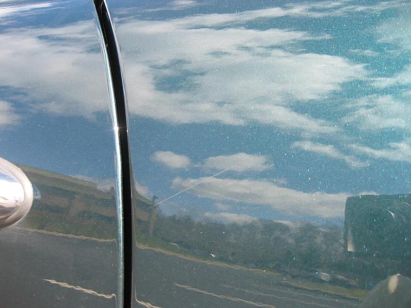

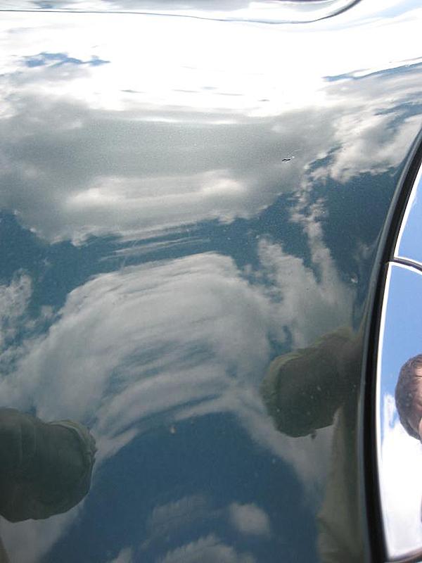

heres more looks

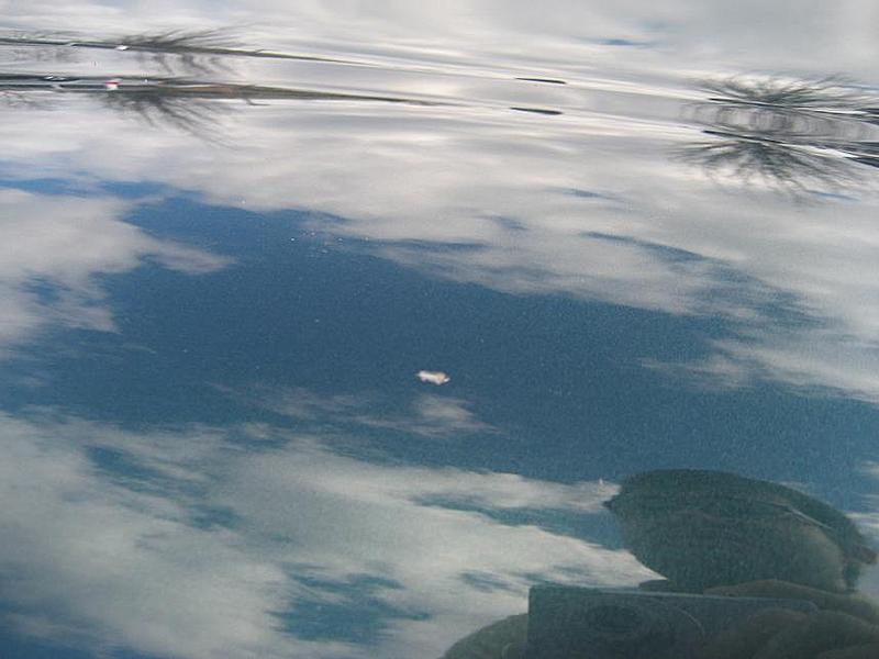

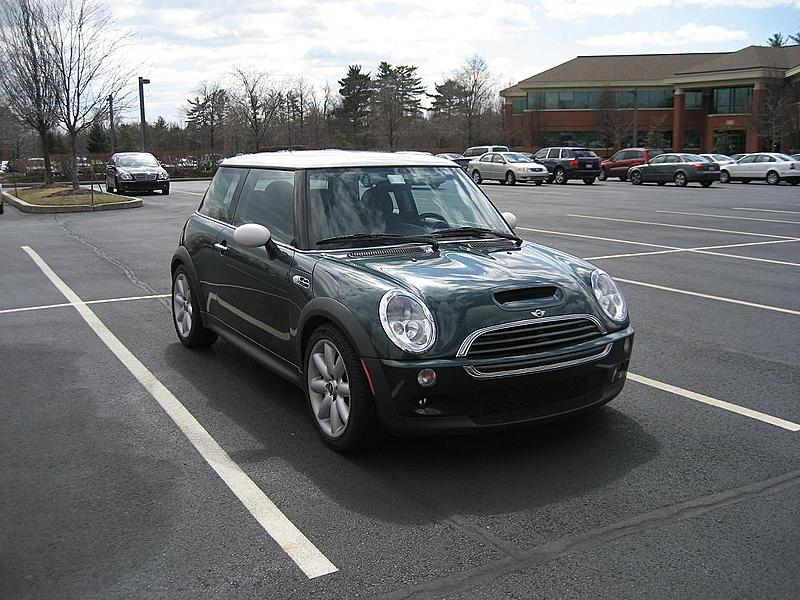

you can see in the last photo that the car looks pretty good from 5-10 ft. even though it rained all day yesterday in PHILTHadelphia

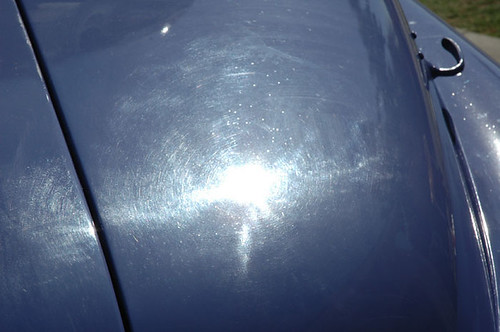

To determine what clay to use, you basically can define it as consumer grade clay or Professional Mild clay. Anything else is generally for body shop use and what that means is--the emphasis is placed on speed, not gentleness to your paint.
Take a look at this car, before using red aggressive clay
Take some red Aggressive Clay from Meguiar's
and now it looks like this
To the consumer, this would be frightening to see. To the professional, this is just business as usual.
I sell the Professional Mild clay because it's just as safe as the consumer clay but works about twice as fast as the off the shelf stuff. Also I like the consistency. It's not too sticky, or soft, or hard to knead.

i'm getting giddy with excitement now. i'm going to practice all my steps with the PC on an old project car i own. its getting a respray when i have money/time to play with it again so i could care less if i ruin it.
does the red clay make it look like that because it is lfting out the fillers and etc.?

No it's physically hazing the surface. You need a rotary buffer to correct that. A PC won't do it. I used the red clay because there were rusted metal welding shavings embedded in the paint, and it was shredding up my blue clay. It worked great for this old truck, but I use it very rarely because of the scouring it causes.
Btw, clay doesn't lift--it shears. It shears the contaminants above the paint surface until it's level with the paint.
A mild clay won't affect the paint, but an aggressive one will as seen above.

Holy crap!! I'm starting to rethink this claying business. If I get those kind of swirls in my new paint and can't get them out, I'll be very upset!!
I ordered Z-18 clay from Zaino...but I just don't know if I want to risk it. I certainly wasn't thinking about doing all those steps. I was going to follow the directions Zaino provides: Wash/Clay/Wash/Polish.

Please read what I said. I was demoing what Professional Body Shop Aggressive clay will do to your finish. The Zaino clay is a consumer clay and not something you have to worry about. The same goes true for any of the clays available from Autozone, Pepboys, Griots, DetailersParadise, etc..

OK, but the clay I got from Zaino is red...like what you were using. I hadn't seen such a terrible outcome before and it's daunting to think about. I don't have an electric buffer, so everything will be done by hand.

The color doesn't matter. Everybody makes a different colored clay--purple, grey, white, yellow, blue. What matters is what clay was intended for. The Meguiar's Professional Red Clay states on the jar it's for body shop use and says Aggressive. Zaino doesn't sell an aggressive clay, so don't worry.
As long you clay with good technique you won't be marring the paint. Bad technique would be like dropping the clay, and getting a piece of rock there, then continuing to clay and now you scoured the surface with contaminated clay...
